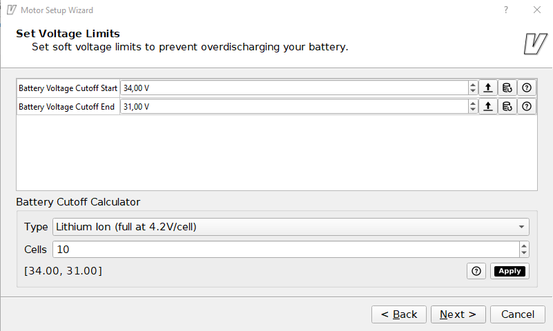

So I assembled my first board and gave it a try. It seems incredibly slow, even on flat surface on full throttle. What could be the cause of this? I am a 73 KG rider, with a single 6355 170kv, 10s2p Samsung 30Q and 36 / 15 gearing.
My vesc settings are:
60A and -60A motor.
Battery max 40A.
Aside from the slow speed, it also had major problems climbing even the smallest incline. However braking was strong and worked very well on all speeds.

Post screenshots of your vesc tool configuration pages. Iā€™d wager youā€™ve set your cutoff voltages wrong or something.

Hmm, those donā€™t look too bad. What voltage was the battery at when you did your test runs?
Connect them up any which way, do your motor detections etc, then test it. If it spins the wrong way, swap two wires - doesnā€™t matter which two.
I talked to the guy I bought the parts from. Turns out the battery came at 34V when I received it, which explains why it went so slow. I will charge up the battery and do another test.
Yep, thereā€™s your problem. Storage charge.

Your symptoms exactly describe a low battery situation. Try charging the battery. With a low battery, you will still have killer brakes but your forward acceleration will be seriously lacking, until at some point you need to kick-push.
