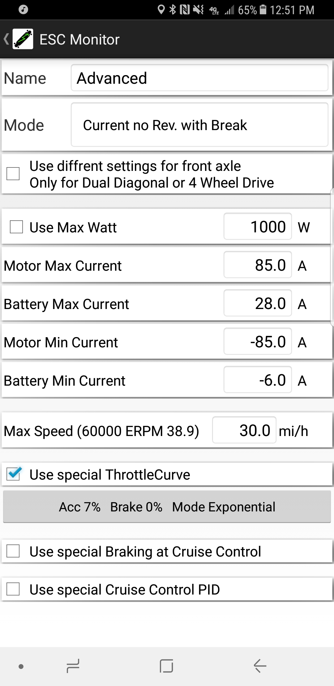

Could someone help me diagnose why one of my motors is stuttering when coasting? (No throttle, down hill). I am using master/slave dual focbox, dual bkb 6374 190kv (running one FOC sensored and the other FOC uncensored) , bkb 11s3p 30q, ackmaniac software and BT app. Here are some pictures, first one is the realtime data of the actual stutter, and the other is my settings.Screenshot_20190304-124655 Screenshot_20190304-125101

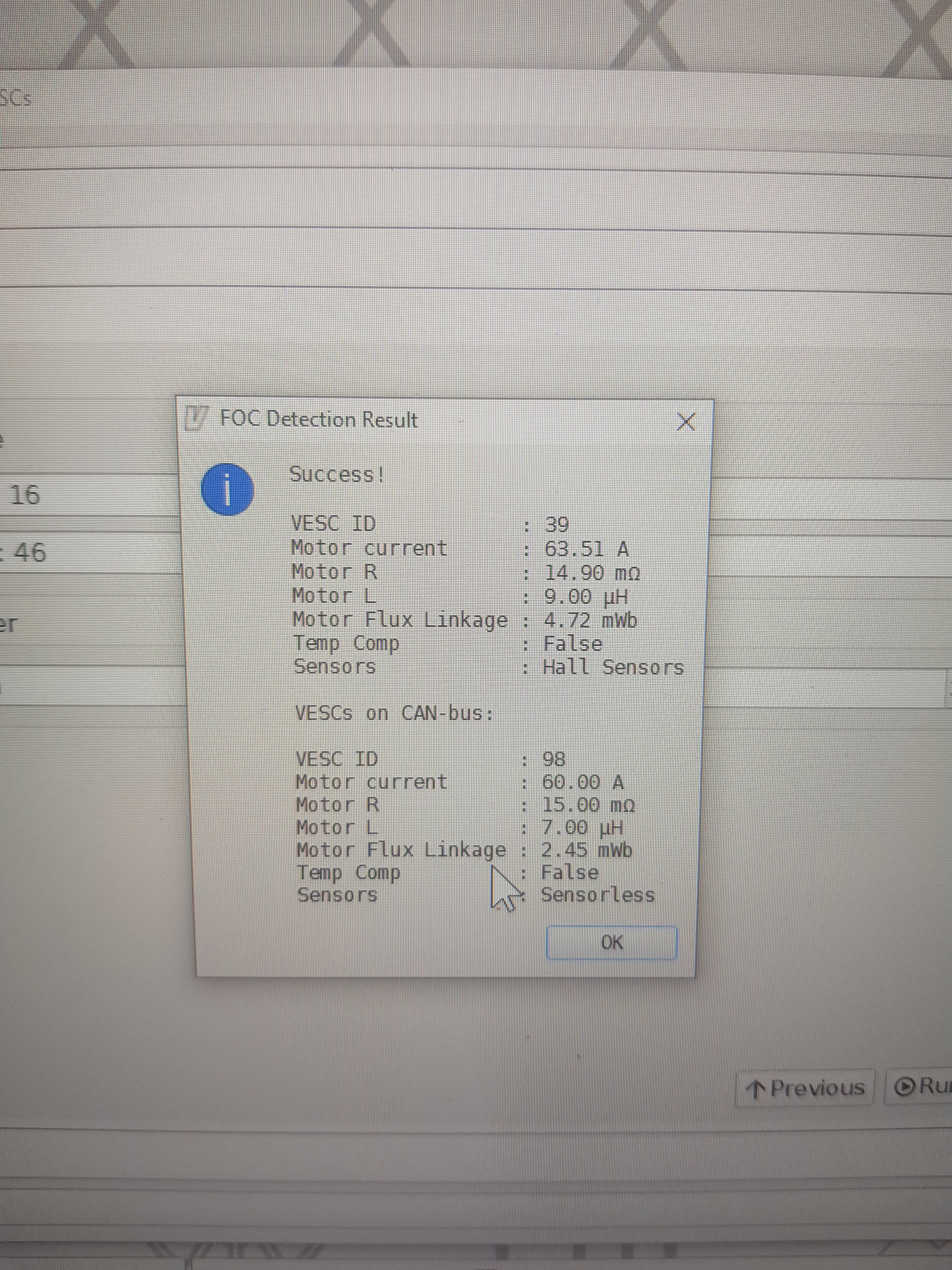

So I am back with the motor problem. I just updated the VESC tool to the newest version. Did the new FOC detection and then got this message when doing the detection. Then I got this result: 20190304_202155
Then I switched connection between VESC`s. I did this because I saw that the 2 motors acted different in the detection. The result was also weird since both motors were wired up and the wires were intact and functioning. So I did a new detection with the other VESC connected. Then I got this result:
Flux linkage detection failed

What do you mean by acted differently and switched connections between vesc? Were you doing motor config on one vesc and then switch to the other?
Might not make any difference but your vesc ID is 39 and 98 normally they are 0 and 1
Earlier in this thread I send a video where you could se a motor moving forward and backwards in a random order. This time the motor detection went quite similar to this. Normally you hear a big buzz in FOC then the motor will spin up and then it will spin slowly when its detecting the poles (I think thats what it does). This time I heard quite a silent buzz but that’s nothing to worry about. But it spun up quite some time after the other motor spun up. And it didn’t do the slowly turning detection back and forwards. So that was concerning to me.
About the first question you asked. Yes First I did the detection on one vesc. But the new VESC tool can do 2 defections at once. I first connected it to my main VESC with the metr module and remote. After having done the detection there I switched to the other VESC and did the detection there.
