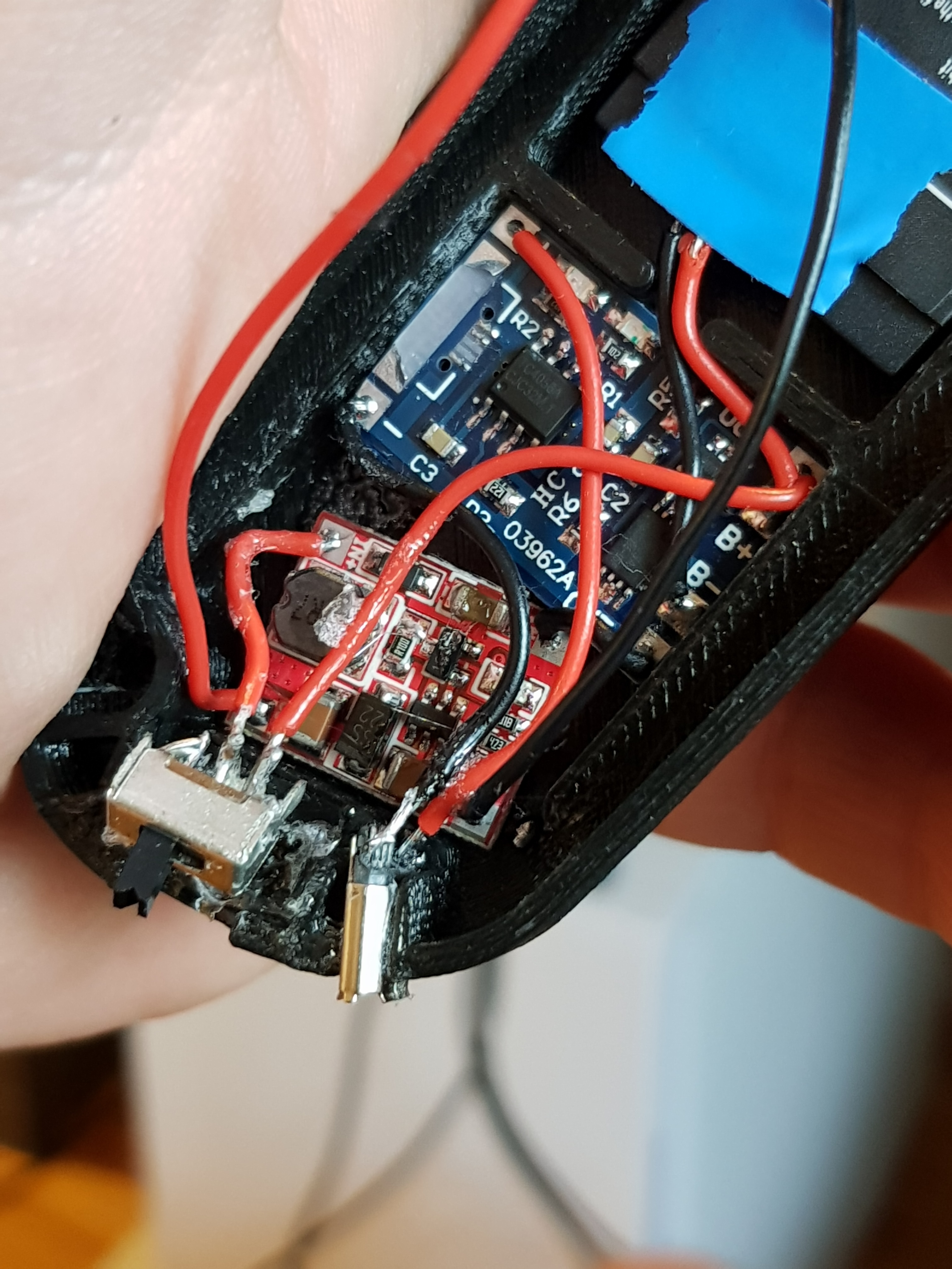

You are using a newer version of the TP4056 than I am, so my wiring setup looks slightly different. According to this video (https://www.youtube.com/watch?v=Qw4psECqpwI) your version of the TP4056 has a built in battery protection IC which may not allow your battery to power your OLED if it’s voltage has dropped below 2.9V or so. is your battery fully charged in order to rule this out? I don’t know enough about these things to say for sure, but if your battery already has a low-voltage protection circuit built in then maybe you don’t need this version of the TP4056…or perhaps it’s even what is causing you troubles.
Thanks for trying to help. I tested and, battery was 3.9V, and oled vcc/gnd showed 5.19V, same as from booster out. Doesn’t make sense for the oled not to work
Charger module if it matters: https://m.aliexpress.com/item/1852201781.html?
Any chance you have the more standard 4056 module on hand to try? (https://www.ebay.com/itm/Micro-USB-5V-1A-TP4056-Lithium-Li-Battery-Charging-Board-Charger-Module/182108324849?ssPageName=STRK%3AMEBIDX%3AIT&_trksid=p2057872.m2749.l2649)
No I have only one type. As the voltage to booster is fine it should work. I guess I could measure current but oleds shouldn’t need much
update: I changed the switch and if I reset the nano while powered the oled turns on. I guess there’s some timing issue that the oled powers up too slow to register IC2 address before nano boots
