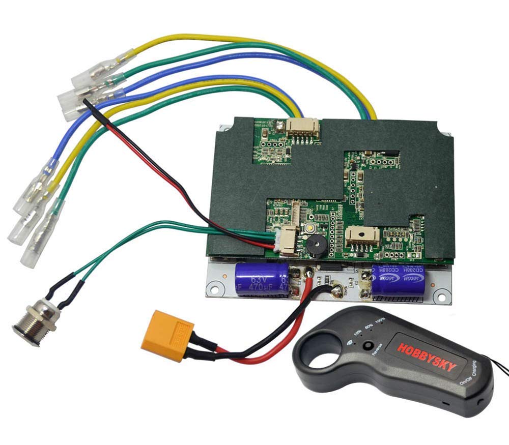

First timer here trying to do a budget build. I bought a Hobbysky 24V/36V Dual Motor Drive ESC with the following specs:
Rated Voltageā¦24V for single belt motor / 36V for dual belt motor Currentā¦ā¦ā¦ā¦ā¦16A Powerā¦ā¦ā¦ā¦ā¦.380W(24V)/580W(36V) 24V ESC must use a voltage above 24V, the maximum voltage can be 29.4V (the ESC wonāt work below 24V) 36V ESC must use a voltage above 36V, the maximum voltage can be 48V (the ESC wonāt work below 36V)

Havenāt built the battery yet; still trying to figure the schematics out. This is the ESC that I have:

What exactly is your problem? You bought the dual esc or the single, or is it one for both? Sorry donāt know this esc, but if the specs say max 48v than you can run it max at 11s. 12s with 50.4v is already too much. You can find any bms on bestech. Just write them an email. No need to call, they replay usually within one day but they have a min order of two pieces.
The esc you have Iām sure is max rated for 10s
Edit: The board is designed for 10s you canāt use 12s or 13s because you will fry the board or if you donāt the voltage cut-offs will be wrong. The amps arenāt the problem here
I was going to charge a 12s to 48 volts using the balance charger to get the most life out of the batteries and the most power out of the ESC and motors but Iām not sure if the amperage would eventually kill the ESC so I thought I would add a bms if it limits the amperage to the ESC? I was also looking at getting the 13s BMS from AliExpress so that I donāt have to buy two 12sās from bestech since Iām not sure if the amperage is even limited by a BMS to the ESCā¦ Maybe Iām just making this more complicated than it needs to be.
