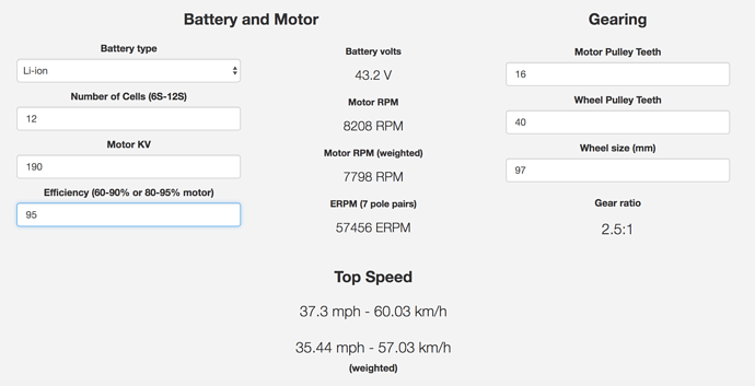

I wonder if my 12s dual 6374 setup even comes close to pulling 1300w per motor anyhow. I’ll uncheck the limit and see what happens as my top speed so far has been 34mph (GPS) and that could’ve been on a slight downhill IIRC. The calc says 35.4 seen here… anyone know what the rider weight factored into this calc is?

That’s what efficiency is for. You only can guess what the top speed might be and the calc only displays top theoretical speed. Looks like you’re pretty on target though. Pretty sure you won’t be getting any difference in top speed. You will pull a lot of watts when hard accelerating or climbing hills, but at speed, you’re pulling a lot less current, and thus, wattage.
