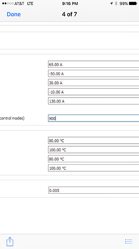

Not that the doesn’t work but just that you’ll have a much higher chance of blowing the chip. Do you have some settings you could suggest for my setup? Here is my main motor settings which seem to be working ok for hybrid mode… I’m running torque vescs and 6374
What should I suggest? What Do you want. If it is fine for you then leave it as it is
I meant a starting point to try FOC mode as I’ve never tried it.
