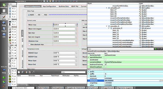

i guess an inductive load would smooth the current out more but still the question remains unanswered “can we do 200 motor amps?”, but I don’t want to be the guinea pig at 100$. I’ll do 40/150 today though.

If you trust the 0.0415 Ohm blind you should have no problem testing the limit of 200A, because it is a limit coded in QT. Why should there be a limit? I think just that people like you can expand them.

The current control loop of a standard VESC with 0.001 Ohm shunts can only measure 160A. ( 160A x 0.001 Ohm = 0,16V -> times 10 by the DRV = 1.6V -> times 2 because you’re measuring positive and negative voltages = 3.2V on an ADC pin which can sample max 3,3V )
If you crank the absolute max amps value higher than this, all protective features of the VESC are overridden.
The only way to use higher currents is to use other shunts. 0.0005 Ohm would be a good starting point, as there is a prebuilt firmware for these.
