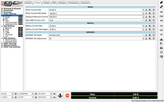

While asking advice about problems with setup you should also include a screen shot of settingsā¦
Example taken from another post (actual screen may differ slightly i.e. āvesc-toolā, āackmaniacā) ā¦
since you are doing dual you would actually cut the battery max in half so you could do 30a or 35a. I have been told and read that you can go to 40a each for the 30Q but to be say stay around 30A or 35A. I think you would be ok with the motors but you could always set the max on the vesc to 60a which is the default. You will probably need to make your max erpm 60,000

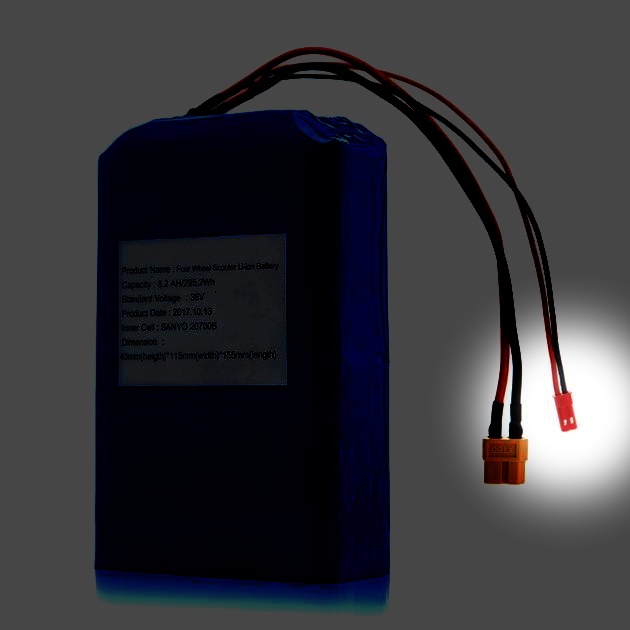

Solved. Meepo uses a 2-pin JST-RCY / BEC connector on charging side.

So may be simple for some on here can anyone tell me if I need to change the settings a bit on my dual vesc with split servo connectors. Here are my settings.
At first I thought may be my problem was dropping signal on remote but I repositioned the receiver but still nothing what happens is when I get on and go it starts but suddenly it stops and the motors tighten up but on the bench test it runs normally may be my wieght is too much for the amp draw. As I also have a bms that tops at 80amps. Any suggestions?
