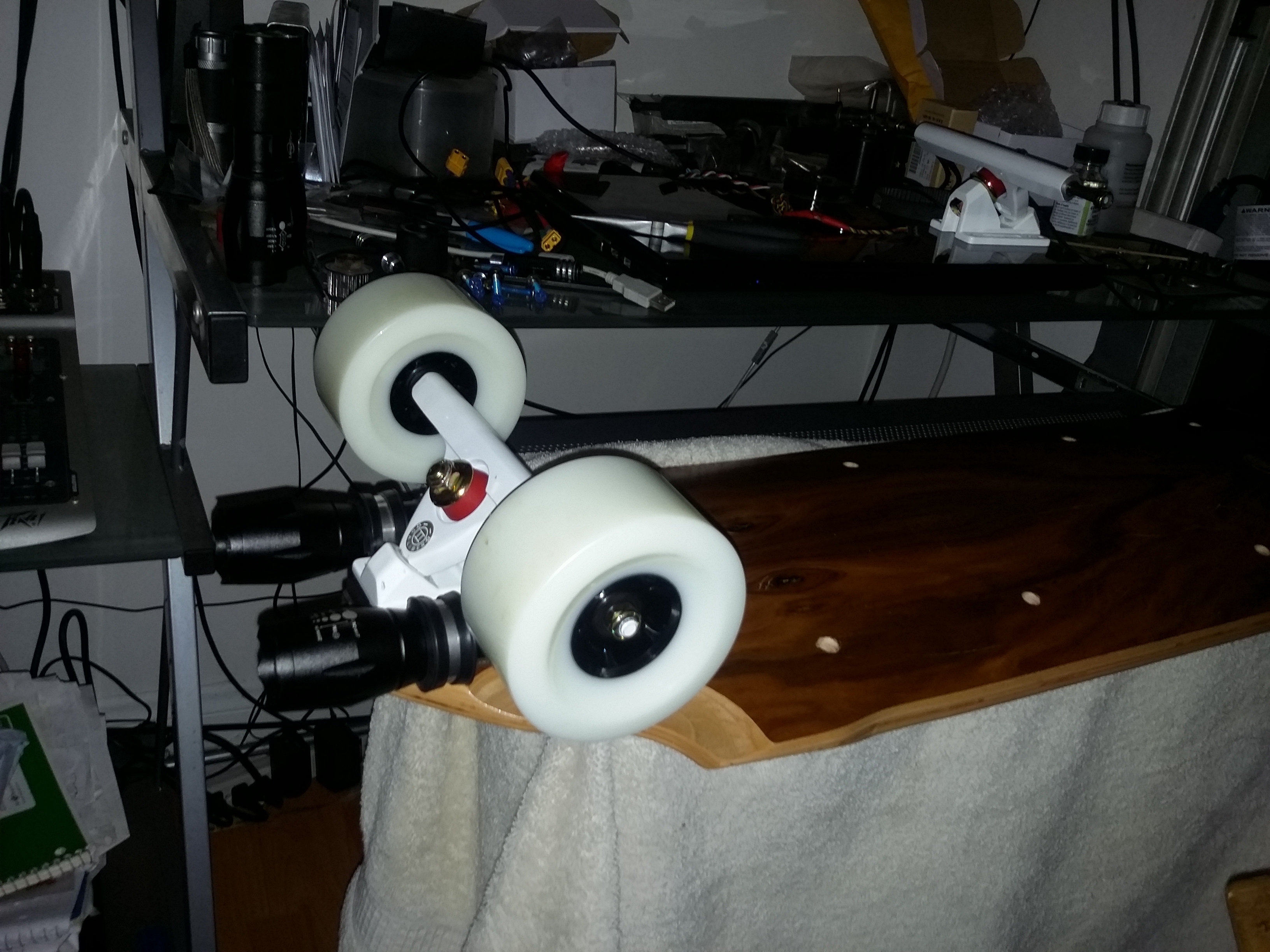

4x 1000 lumen led flashlights equals 4000 lumens of “Bonding” I mean blinding night rides. They are the kind with the zoom heads. So you can point them down the road or have a wide beam. Or one down the road and one wide.Where is the rocket launcher?
Hahahhahhaa if I was a girl and saw you like that I would instantly get naked. Best build ever
Hahaha…I should seriously head down the road like this. I really think this board should be in the next Bond flick. Lol
