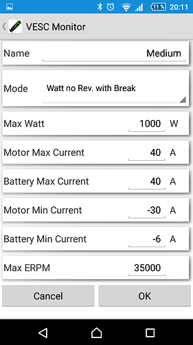

Here are my other driving modes and I have to say they work very good. Kid modes goes up to 6kmh, beginner mode up to 25 and medium up to 35 kmh.

Very nice video. But let me give you a view tips. You are overstressing your batterys a bit. Because you have a 10S3P battery (i guess samsung R25 cells) and set your battery max limit to 50A each VESC. but the battery is only rated to 20A continuous. For a 3P setup that means 60A. That means you allow a total max amp draw of 100 Amps for the Battery. You can do that but it is a bit much. And what is the value for your your Voltage Cutoff start and end. Because i think it is a bit too high (reduces power too early). So i recommend to set the cutoff start to 30A and cutoff end to 28A. And then the best would be to set your battery max to 30A for each VESC or if you want a bit more power to 40A.

My cutoffvoltage starts at 32V and ends at 28V, but I have a 60A BMS that cuts voltage at 30V. I have LG2 cells, so 60A is correct. Thanks for the tips with the battery max, I’ll try it with 30A then (I have a Vedder-switch as well with a 40A fuse). What about my Max Watt? Should I leave it at 1700 watt?

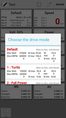

Just a minor bug fix: if you choose between different mode setups you cannot read the complete ERPM value because the last digit gets cut.
PS: The new features are nice. Keep up the good work
When you set the value to 30A then you should set the max watts to 1080 (3,6V * 10S * 30A = 1080 watts). if you set it to 40A (at your own risk) then 1440 (3,6V * 10S * 40A = 1440 watts).

Can you please make a screenshot of that. By the way in the new version you don’t have to deal with the ERPM anymore. You set your tire and pulley size and the motor poles and then you can adjust the speed instead of the erpm.
Looks like you have a very small screen and the values don’t fit. looks different on mine. That is the problem with Android devices. There are so many different devices and screen sizes. But i changed it already on the new Version. Hopefully it will work then.
I have a OnePlusOne 5,5". I do not think that it is small
