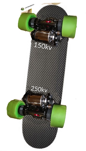

This is awesome. Ya’ll know what would be sweet mash up of unique ideas? Carvon skates dual drive from a single motor (pictured) x2 using the Stacked KV motor idea in this thread. Credit to carvon for the drive set up, I just like pictures.
