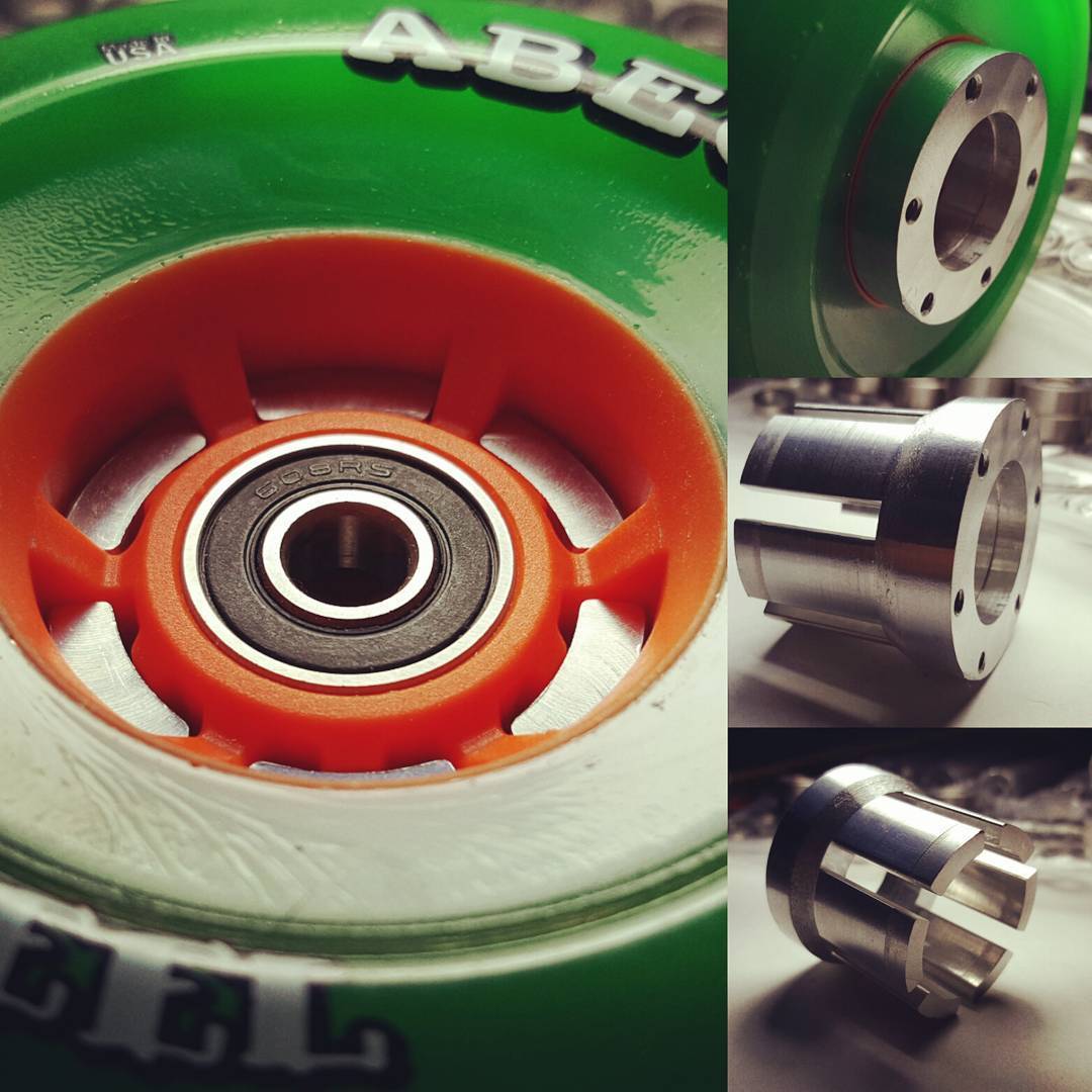

Canāt be the exact part unless you hacked my computer! This was designed on FreeCad and mounts to our drive pulley. The drive pulley rides on a machined truck hanger. Barely any material is removed from the hangar so it isnāt weakened like other designs.

This is impressive, especially in terms of raw material quality, cost and precisions. Especially compared to extruded options.
Reminds me of when apple came out with the unibody macbook.
that will make it super easy to rotate or change wheels!!!
I just replaced my wheels and had worn the drive wheel down from 97mm to 91mm
While my other wheels only lost 1 mm

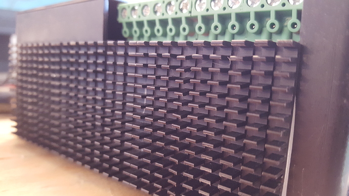

Note on the g540 drives, they can use some heatsinks. Used a buck converter and powered a small 12v pc fan to keep it cool. Once things settle down I will mill a custom heatsink but these work fine for now. Barely warm to the touch, even at high feed rates. I fastened them with some silicon heatsink plaster.

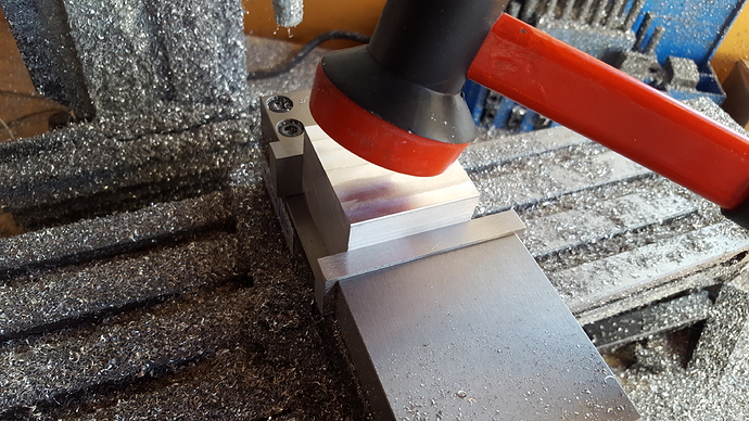

Hereās a quick tip, I did start this thread as a resource after all.
When locking parts or fixtures into your vise, snug it slightly and give it a few quick taps with a deadblow or rubber mallet. You will hear a barely audible ping once it is seated. This keeps things accurate. Once seated lock it down.
