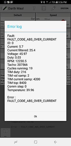

Thats an over current code not DRV. Ive seen that before, I raised the absolute current threshold on my builds that run high motor amps and that code went away.
But that code does pop for other reasons like DRV…
