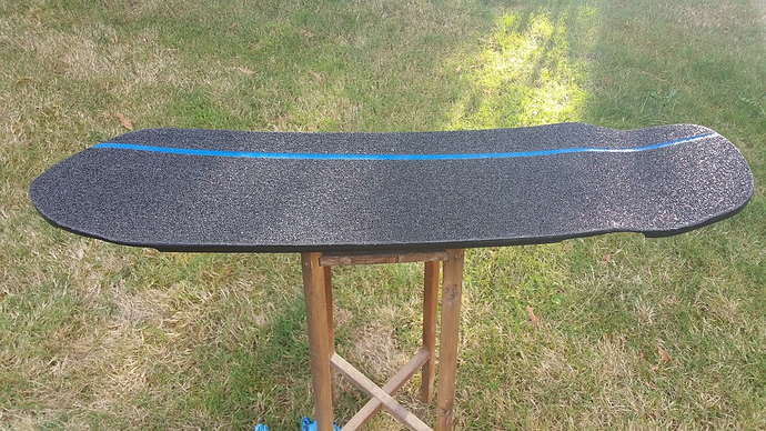

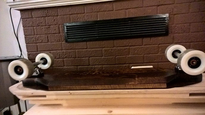

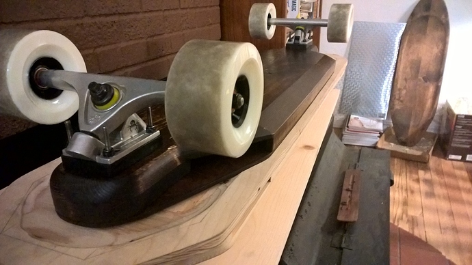

Put it together and took it out for a spin on 97s no grip. Gotta be careful with no grip. Almost had a SYF scenario…No power yet, just testing the design…Got my nice white wheels dirty and put a little wear on em’.

(Pic from @sl33py Board build.)I’m working really hard at the design. I’m trying to integrate the electronics inside the board, but I am also trying to be careful not to copy Chaka! Now that I have a pine one built, it’s time to build some out of stronger and nicer looking woods. I’m waiting for Dexter@ to come out with the 40T pulleys for my 90mm ABECs. Things are moving along…
Yep, in the pics above you can see the pile is growing. I’m working out some designs, but not letting myself get too “Stuck” on one idea. Tech is changing all the time and I want my boards to be somewhat future proof. Initially the idea was to give this board a nice finish so that I could do a cool custom grip tape design. I am not sure If I want to clear grip or liquid grip it or what…I’m already working on the next prototype. I got the concept done in pine, but there are a lot of cool woods out there. How about Flame Maple…Like my electric guitars…I just love that wood and I have some from a couple of custom guitar builds I did last year. It should be much stronger and amazing to look at. Here’s some of what I got lined up…Whatcha think?

I love the work put in here. Great work. But there’s no concave, which was the problem on my last board I built. That’s why I’m pressing my own decks now from veneers. My new board solves a lot of the problems that arise from having no concave, by pressing concave.
You are right. That is a totally reasonable concern. No concave at this stage. Not a big deal. This is a prototype, so I opted to go with less labor steps for this one. Because the top piece is separate from the base and also much thinner (3ply), It is a lot easier to press a concave than trying to press a super thick piece. Using a flat piece also reveals how durable the top piece would be under load. If it’s gonna crack, it would be a flat piece over a concave piece any day…NO cracking, no sqeeking, and it has a nice responsive ride feel. I actually expected it to be a little more unstable than it actually was. Riptide Krank double barrel bushings and WTB pivot cups…(93A boardside, 87A roadside. 42° Buck trucks w/ 1/2" Luxe flat risers.) It would also be feasible to change tops out with different concave radii and profiles. The tops bolt to the support rails that go down the length of the board. This is designed to allow a lot of adjustment and testing for me and for a customer to experiment with without having to buy and change out a whole new deck!! I’m already working with a longboard maker out of Huntington Beach, CA to make me some prototype tops for testing. I want to have some options available. The standard profiles are already established, so why not just go with what already works and support a really cool family based company from Cali? Pressing decks is not difficult, but there are issues that can arise. For one thing, the cost of DIY pressing is MUCH more expensive than getting them made by a company that not only has years of expertise, but also the contract pricing set up with their wood dealers. Even after they tack on their premium it still comes out a lot cheaper than if I did it myself. Labor is a big factor… Who knows…I may try to make my own too, but It’s looking like I’ll be able to farm that work out and experiment with some other options later. If all works out, my next prototype will have optional tops in W-concave, 20" radial, progressive, and I want to develop a good asymmetric concave for goofy footers… That is where I may want to try and do some DIY pressing, so I can really get in there and experiment. Prototyping is like jumping out of an airplane and then furioulsly trying to sew together a parachute before you hit the ground! LOL I look forward to seeing your designs too, bro! It’s a lot of fun going out on a limb and doing something totally different!
That prototype stage is good. You have a good design going. I’ve decided on a wood lid for my next board. 1/16 veneers have been time consuming to build with, but the results have been great. Curves fell better. Hummie doesn’t like to go more than a 15 mph on my board cause it has no concave. So I’ve been pressing this deck from veneers and his deck. Cause of sanding, it’s basically a slightly smaller version of his deck. You should check out veneers and pressing with them some time when you have the time. I’m starting to think this is he best way to make a solid deck
I was sliding that board I made without grip tape, so it’s not too horrible. I did have some sketchy moments around tight turns on mild downhill sections. My front foot was trying to slide up the front of the board. I had to use my upper leg to resist. With no concave, I have found that as long as the ride height isn’t too high, your bushings are appropriate for your weight and adjusted properly, It’s not too bad. It has a bit of a “tippy” feel. The center of balance is still in the center of the board, it just feels weird. You have to have some curve. You can also build up areas to create curve or w. Some people take grip tape, dense foam, duct tape, or other stuff to build up sections to get the exact foot feel they are looking for. In theory you could build up a flat surface with raised edges and get a pretty good feel. Here’s a cool write up on the topic. From the guys over at MotionBoardshop…
