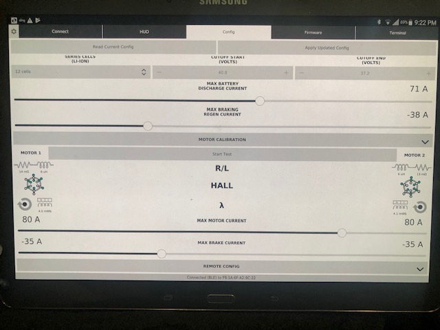

@ninTHIENdo can you run the faults command from the terminal after you trigger the behavior? It’s possible that the sensorless transition doesn’t happen smoothly causing a current spike that triggers an overcurrent fault. Luckily this only occurs at that low speed transition from sensored to sensorless driving if that’s the cause, but I’ve found that tweaking the transition rpm can fix this issue sometimes. Can you share a screenshot of your motor config values from the app?
