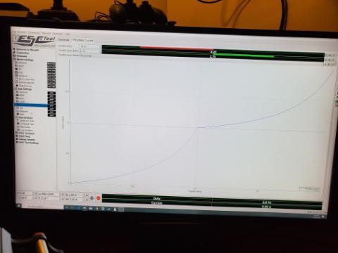

Hello again. I already did that on the remote. That was the 1st thing you helped me and 1 other person fix so thank you for that.If i understand correctly, in the vesc it is 14 poles and in the remote it is 7 pairs. so believe mine is already correct, right? Speed was wrong until that was fixed. Now speed on remote appears to work. Only issue i have now is the throttle response is only about have the travel of the throttle switch. Again, someone posted they had 6 of these remotes and that is normal. Not complaining if that is the case, it is working correctly as near as i can tell now just not as much travel for the throttle as the switch. When i tested the remote it gave a range of movement of roughly 99.9 forward and 79.9 back. This range was maxed out in both directions BEFORE the switch gets anywhere near end stop position. When i set up the throttle, it is the same. I know the power curve i have is a little too aggressive so will be adjusting over the 4 day weekend but that will not change the travel of the throttle switch right? I am an old RC guy and EE so i think i understand what is happening here just not sure there is a fix for that, may be nature of the design unless you tell me different?

Can you show the video to be clearer? The remote throttle is controlled via hall sensor and two springs pull and push. During the production process, any little tolerance value will result in the two sides difference. It has no effect on speed and other data display. Setting this as an example, the less 79.9 one will be more sensitive when pulling.
Good Morning and thanks again for sticking with this. Vacation starts tonight so will get on those videos as promised. This sounds exactly right. Only question i have is where is that setting located? I hope this is not the throttle curve I have been playing with. I can’t wait to get the throttle dialed in, everything else appears to be going well with the new board so this is the last tech hurdle to make it a truly sweet ride. Too bad, Thanksgiving is not a holiday on your side of the world but I wish you a happy 1 none the less.
Hello. Happy Thanksgiving. Yeah. The data you mentioned is the hall sensor ADC sample data, display not in the middle for some mechanical structure tolerance value in physical production. It doesn’t have the effect on speed, battery and other data display. The hall sensor is located in the case. The throttle control via the spring pull&push nearby.
