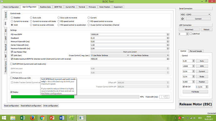

Hey Ackmaniac - where do you adjust setting to have it backoff power at 52km/h in the tool? Sorry if this has been answered elsewhere.
[edit] ignore this question - I was only thinking of the motor config tabs, I’m assuming you limit this under the PPM soft ERPM limits section
