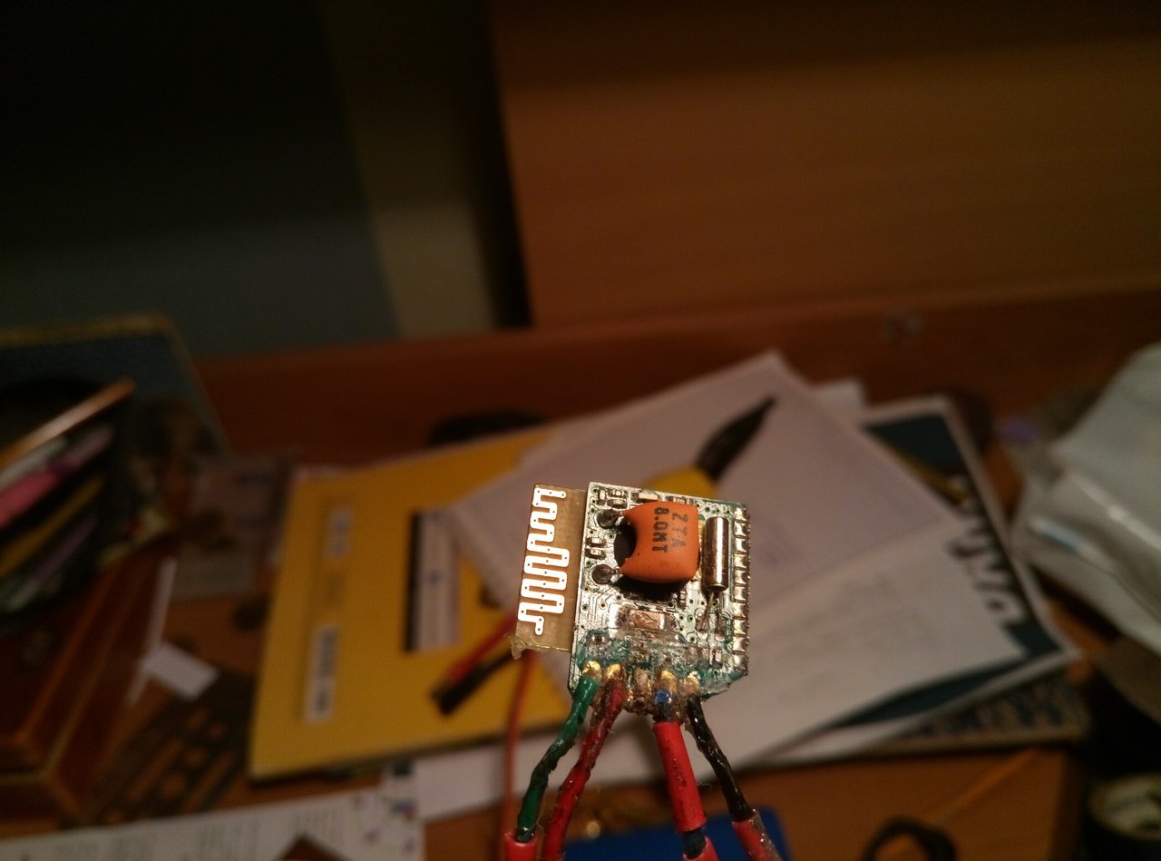

could i damage a receiver? i soldered everything, tested it, everything worked fine, than i hot-glued it, got a problem, melted glue took picture
How is it wired on the VESC side? Also, just be sure that there are no bridged joins on the receiver (including the rest of the circuitry). Other than that, your problem is most likely due to EMF interference from the VESC / motor, or wiring.
the problem is, that in some point it worked fine. and im doing everything in the same way.
any ideas how to fix this? there is no bridges on receiver,
Hmm… Perhaps you changed a setting in BLDC tool? Maybe disabled Nunchuk control? Or possibly the remote or the receiver is damaged. If you’re confident that the receiver is good, and it’s connected to the vesc good, then I would start looking at your settings, or the remote.
Ill start with the settings, thanks. Receiver looks solid, no visual defects
It could be the batteries in the remote Are they fresh? Swap them out for AAA’s that are at least 1.4v, just to make sure we aren’t missing anything here.
Remote is brand new, batteries too (stock). Have it for 2 weeks, made only tests
Well, i reinstalled firmware, applied settings, and problem stayed the same(
its 100% hardware problem. its impossible that it shows “over_voltage” error when gt2b and nyko receiver are connected in the same time with no reason
problem ether in receiver or in vesc. but how to fond out where exactly? the good thing that gt2b works perfrctly
In BLDC Tool, go to the “Terminal” tab, then type “faults” and hit enter. This will list all the faults… What shows up?
And just to clarify, you have tested the GT2B and the Kyko with the fresh firmware? What hardware and software versions are you running now?
