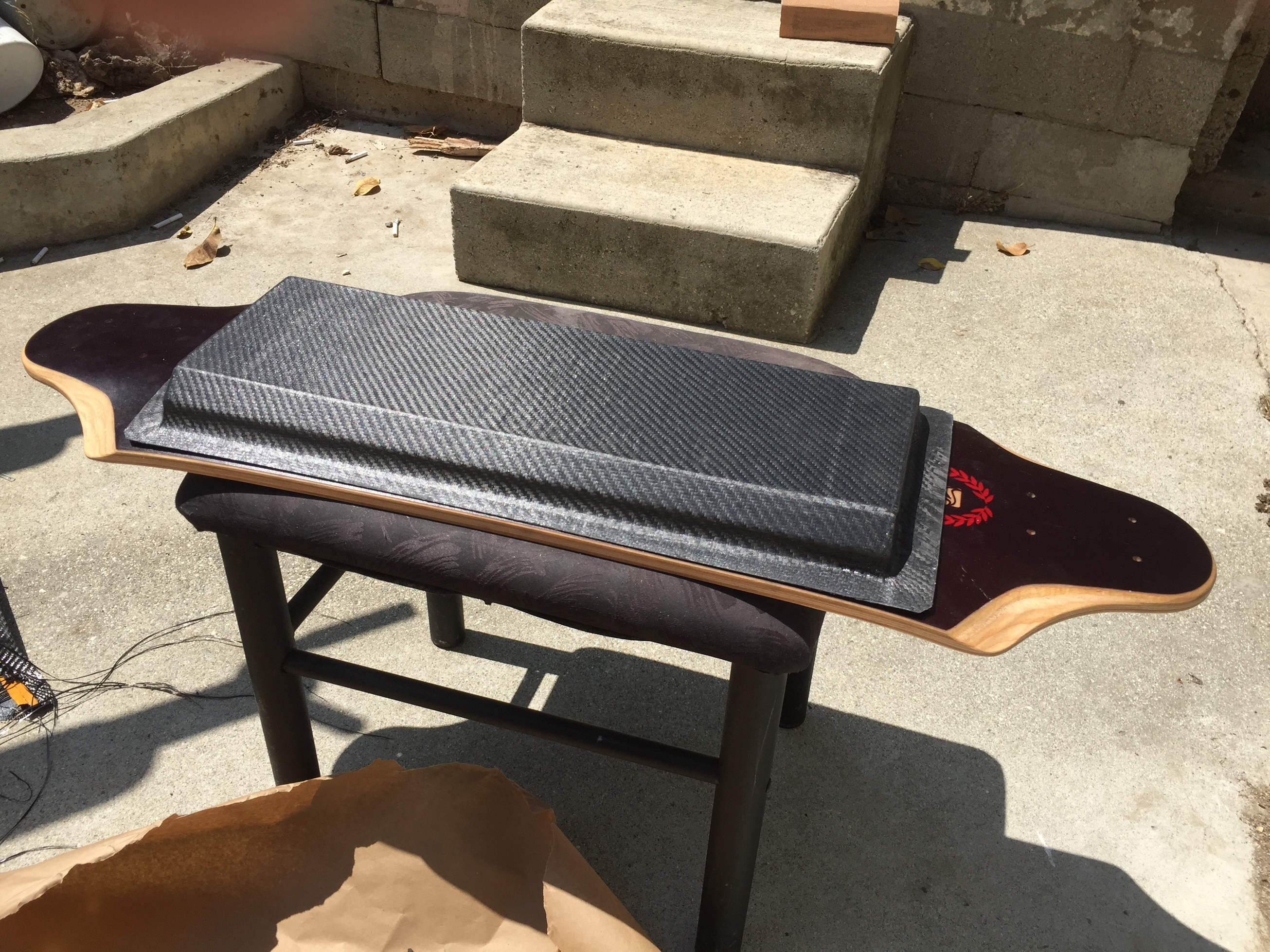

I bought a bunch of carbon fiber materials to fabricate a custom enclosure, which was a HUGE MISTAKE. With the amount of money I have spent on materials so far I could have just bought a carbon fiber deck from Enertion. I can’t emphasize this enough. If you are seriously thinking of fabricating something from carbon fiber, DON’T!!. It is really expensive!!! And not worth the time and money.
My original plan was to make my own custom wood/carbon fiber deck. I was going to cut a hole in my Landyachtz Top Speed deck and lay a top layer of carbon fiber so most of my components could fit inside the deck. Soon I came to the conclusion that this was somewhat overly ambitious for my first build. So i decided to use the materials I bought to make a custom carbon fiber enclosure instead (even though buying an plastic ABS enclosure would have cost me a fraction of the price, man do I regret buying all these materials). In the future I may still build this deck, but for the mean time being I’m going to keep it simple.
Also, anybody here with experience in laying carbon fiber? I was thinking about covering the wooden mould in tape, so i can use the tape to make the mould sit flush with the board. I figure as long as i cover the tape with release agent, the enclosure should still release when the resin dries, and at the same time protect my board from any resin getting on it. Anybody think this is a good or bad idea lol? This is my first time laying carbon fiber.

Today I am going to attempt to lay the carbon fiber. I covered my wooden mould in tape and tapped it to the deck to make the enclosure sit flush with the deck. Then I covered the entire mould in release wax.

So my first carbon fiber lay was a total DISASTER. I definitely spoke too soon when I said, “It all went pretty smoothly.”. I was completely done, literally walking away, already patting myself on the back when i hear a “SNAP!!”. When i came back I had seen that my wooden mould had collapsed. I screamed in frustration. I’m pretty sure the whole neighborhood heard me.
The epoxy I was using has a working time of 70 minutes. At this point, it was way past 70 minutes. I had no other choice but to open the bag and try to fix it. I was able to wedge some pencils underneath the wooden mould to support it, which was only semi successful. At this point, I was also out of vacuum bagging, so i had to try and recycle the old bag i used earlier.
If you look closely, you can see a dent on the right side where the wood is sagging.
On a positive note, this was a lot of fun and it was indeed a great learning experience, but now I am out of carbon fiber, vacuum bagging, and tape.
I really hope my enclosure doesn’t turn out too bad. I would like to use this one for the time being until i get enough money to buy more materials and give it a second shot.

sorry man - that’s no fun. Yeah, i was playing with vacuum bagging and it’s pretty impressive how much force it exerts on the deck! What i learned the first time is that Poly resin is AWFUL. Stinks, doesn’t stick to anything except itself… I ended up removing it from my board w/ just my hands and started over w/ epoxy the second time (and sanded to bare wood - i was an idiot).
I’ve since done some hand layup and will be re-trying some bagging next. I started small w/ reinforcing (and cosmetic) on some simpler decks (better than the blank wood and a bit stronger). Will be doing an enclosure next and might try vacuum again. But using solid MDF to make sure and support it fully and not have any collapsing issues like you saw here.
Your bagging material may be re-usable! Cut the butyl tape off of one side and if you have room to still squeeze the board in leave the other 3 sides? Or if you have enough excess to make it a bit smaller but still fit?
release film - need new, but Breather fabric - you can use blue shop paper towels! It’s just there to soak up the excess resin. Doesn’t need to be the thick white fabric - just do several layers of the blue shop paper towels instead.

Well. despite my wooden mould collapsing, I was able to salvage a pretty decent enclosure. All things considered, I think it looks pretty legit. #happycamper#firsttry
Here is where I shoved in some pens at the last minute to support the wooden mould after it collapsed. I cant believe I was able to salvage this disaster when it was well past the epoxy’s working time. The lesson to be learned here is to never underestimate the strength of the vacuum. When i sealed it back up, I didn’t have enough bagging to make an actual bag, so I had to seal it against the table, which caused the deck to flex when under vacuum pressure. Hopefully it didn’t do any damage to the deck. It seemed to go back to its regular shape after I released the pressure.
