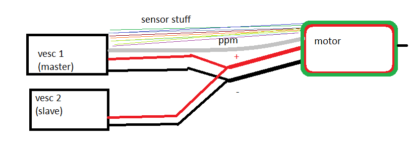

Is it possible to wire up dual vescs in parallel for increased current to a single motor?
IE: dual motor setup w/ chained canbus’ed quad vescs with each motor having a master/slave (master=power+pwm+sensor, slave=just power).
If not, why? +Is this something that could be available via firmware in the future? It seems like amps are the limiting factor w/ vescs, especially w/ 63mm, but that could be a potential stopgap solution until vescs catch up re: amp ratings… Just imagine >100a cont+FOC. I haven’t seen any evidence this is currently doable, but I don’t know enough about VESCs to come up w/ a reason why it couldn’t be.
If so, any info/examples on this? I haven’t had any luck and usually my google fu is strong.
edit: it’d look exactly like this rendering:
…but w/ a canbus connection
Also, if VESCs support up to 60v, what is preventing people from running 13s (…or even 14s)?
one vesc interrupt the other for current measuring for motor. so no it won’t work. probably fry both vesc
could be voltage spike prevention headroom. I’m just assumming tho
Thanks for the reply, but if it’s not possible currently, I’m still not clear on why it couldn’t be possible (if there was a master/slave canbus configuration for managing the current? how would the current be interrupted?)
I’m not expert on this but sensor in the motor only good upto first 1000 rpm after that esc have to measure current draw to calculate rotor position and predict for next current draw. if u put 2, well one or the other will detect abnormalities in measuring and try to correct it. I won’t work

…but isn’t that kinda what CANbus is for?
cuz 2 motor 2 vesc can draw exact math for rotor position and canbus is communication line. but if u use 1 motor there is no answer for vesc to draw out. unless some magic code or math can fill in the caos for two. I’m just assumming from what I read bldc basics from Ti. so I could be wrong.
Did those other ESCs you read about support CANbus though ? I’m guessing they may have also said you have to split the receiver PPM signal for multiple ESCs?
AFAIK canbus can transfer 1 MB/s AND I believe it supports full duplex communication… which seems like it would be more than enough to allow the master VESC recieve/calculate/send instructions to the slave (based on both ESCs current…receiver input, etc, etc).
I know I keep poking, but I am hoping to know definitively if it isn’t possible… even if it hasn’t been supported in the past.
it sounds plausible. but I haven’t seen one yet
