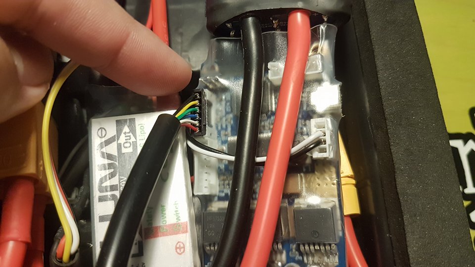

Apparently i can’t get one of the motors to run sensored. When running a motor detection for one of them, as usual it will disconnect from the computer. I switched VESCS and the same thing happened. So i’m certain it’s the motor that is causing it, not the VESC. And this occurs when i have the sensor wires plugged in. When i remove the sensor wire, it can be connected to the computer again. Does anyone have a similar problem like this on TB motors?
is i plugged into the right port? pics plz

Here ya go, this is where i plugged the sensor wire to.

It goes in the connector that under the red cable
