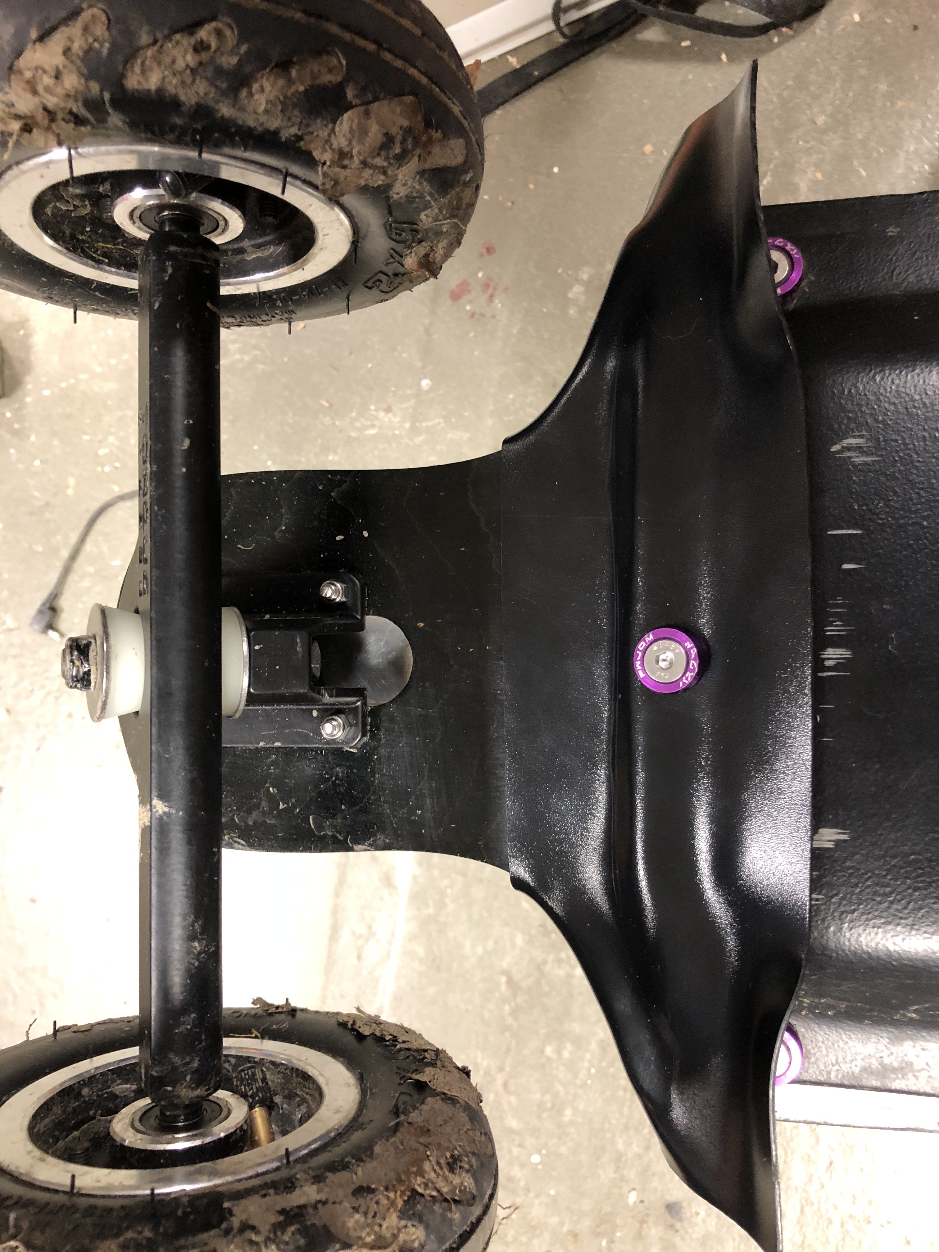

I’m loving taking this board off the beaten track… the enclosure is keeping the water out on muddy trails and the performance off road is surprisingly good… the only thing that was concerning me was the pelting that the front seal was getting through puddles and wet grass.
So here we have bodgy kydex clip on mudguard mark I
