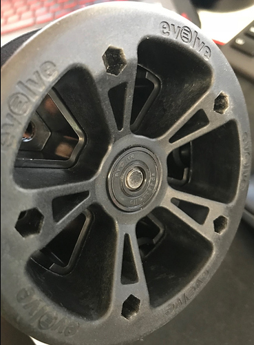

Evolve uses a regular skateboard bearing on their pulley.
You just need to sit the bearing on an 8mm axle and then you can thread the wheel onto it.
This image is how it looks on a 218mm Truck.

i c the problem now with the hanger . looks like i will be cutting. i put on regular berings, still needs more space for TB218’s. with a single bearing it will sit on there ok, but cant say thats safe at all
