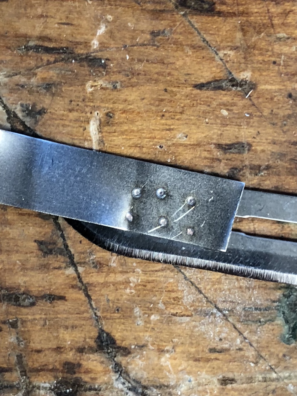

Just practicing my welds before settling down to the battery welds…
How much heat marking is acceptable on the back of the weld? I’m welding pure nickel to a scalpel blade (0.38mm thick).
Both the pattern of 4 and 2 are strong welds but I used a longer dwell on the 4 (15mS as opposed to 12mS)
