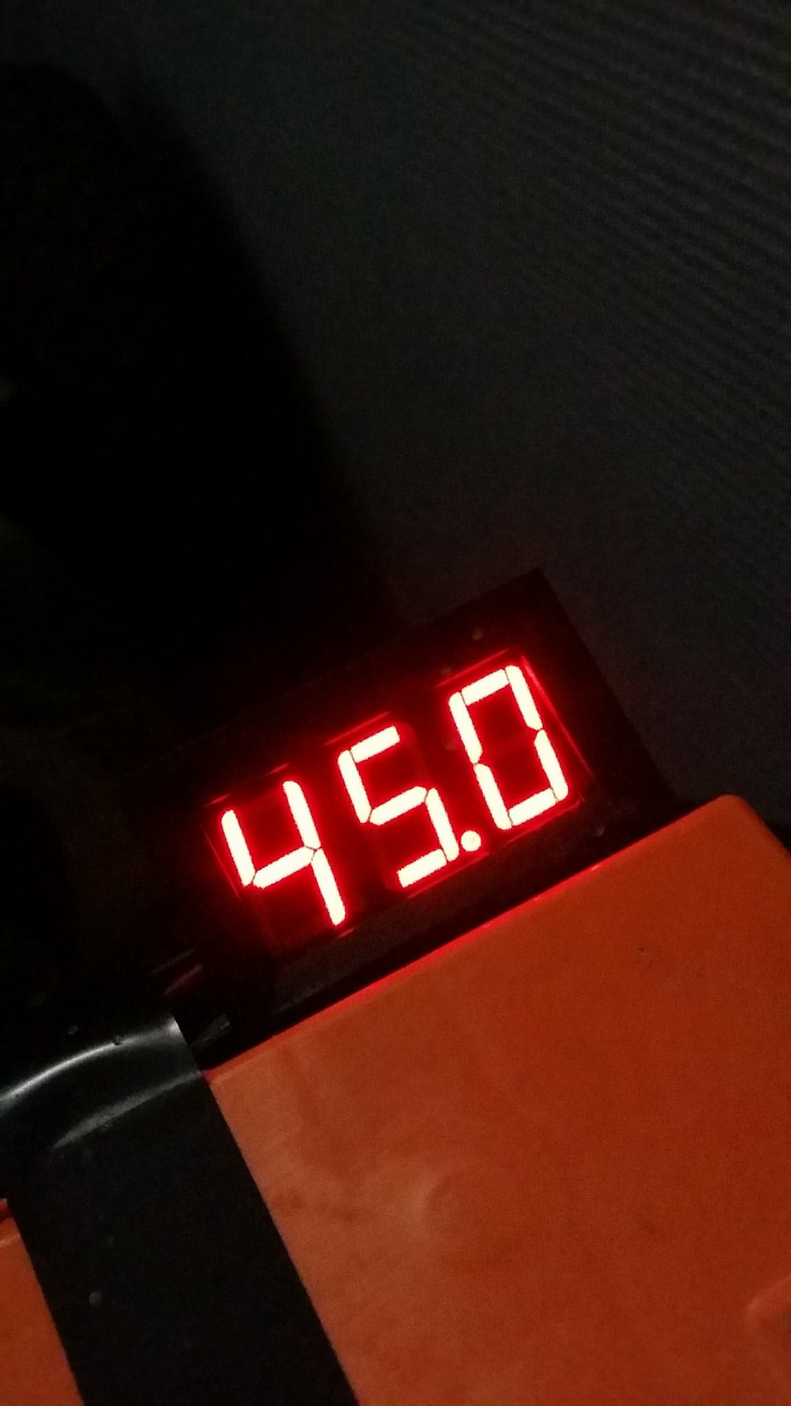

After that, when my face was frozen I came back home, battery voltage was 45,0V.
I was completely shocked during that ride, voltage sagging during full acceleration was around 0,7 Volts! I am currently waiting for BT module so I will be able to upload some charts from BLDC app.
O checked each cell and they are balanced quite good: LV: 3,71V, HV: 3,75V. << NO BMS so far
