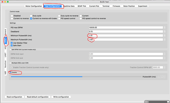

And if everything still doesn’t help then please make a video of the PPM Screen while you have the Display checkbox enabled. When you start to pull the trigger you should see that the % inreases and when the trigger is pulled fully then it should be at 100 %. If you pull it half it should be at 75 % and when you relese it it should be at 50%. If that’s not the case then adjust the values for minimum and maximum until it fits.

Then check the ppm settings. Connect to the vesc in the BLDC-Tool. Go to the PPM tab. Switch on the Display Checkbox. When you release the throttle then it should be at 50%. When you pull it half it should be at 75%, when you pull it full then it should be at 100%. If that is not the case then adjust it with the minimum pulsewidth and maximum pulsewith values.
Yep, everything is right, when released at 50%, when pulled at 100%, and in the middle is 75%…
