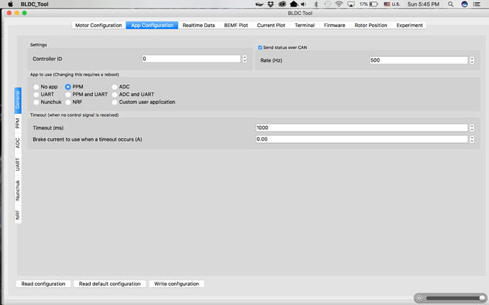

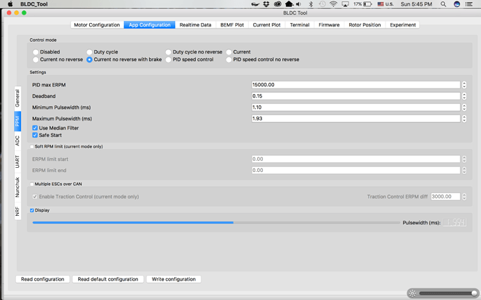

But the motor steps in to hard. please make a Screenshot of your PPM settings. I think we can find the issue there. Just set it in the PPM window to disabled and then switch on the Display checkbox. Then you should see that the value changes with the throttle. Once that is working and adjusted correctly you can switch it back on and have fun.

But yes, calibrate your ppm setting like @Ackmaniac suggested
Yeah, I calibrated my PPM settings… Is that the same as the throttle range calibration? Anyway, I put a load on it (both standing on it and putting it on the ground without standing on it) I took a couple videos which I linked below. When it was just on the ground, it moved, but it still went full throttle after a bit of “jiggling” When I stood on it, it would not move, instead, the motors just moved back and forth very quickly (ie - jiggling) it was kind of moving/rolling backwards though? I’m not sure. Any ideas?

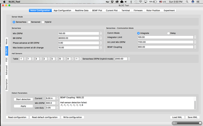

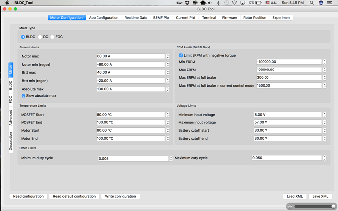

can you post a screen shoot of your parameter ? I think you might need a little push to make this board move (you should test it outside, a try to take on more speed)

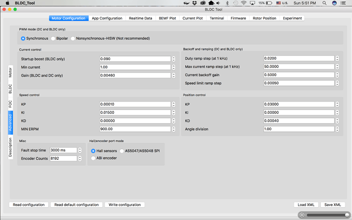

You can also slightly increase your startup boost in the advanced tab
I believe the start-up boost is 0.09 ^^ but that’s only on one VESC
Is the traction control enable ?
VESC is not over CAN. Y servo connector
Can you post screenshot of your parameter ?

OK… It weird because the MAX CURRENT RAMP STEP is suppose to be at 0.0400 in the 2.18 default parameter. But in the 2.16 Firmware it is at 50…
Can you go in the Firmware part of the BLDC tool and make a read.
