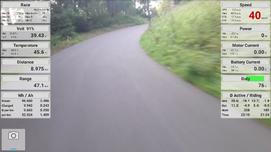

Ride till the dark 40km with over 20kmh average less carving but more hard aceleration and braking …

@Ackmaniac Really looking forward to your app to track my rides, would love to see my watt consumption …
Nice! I think you use FW 3.26, or? On HW 4.12 @Ackmaniac app doesn’t work, only in FW 2.18 or 2.54 it worked, that’s my experience so far.
@rich Thanks for ya input. You are absolutely right, with FW 3.26 on HW4.XX it does not work for long, really strange it works super short but then never again… testet this on 3 controllers… with 2.54 it works like a charm

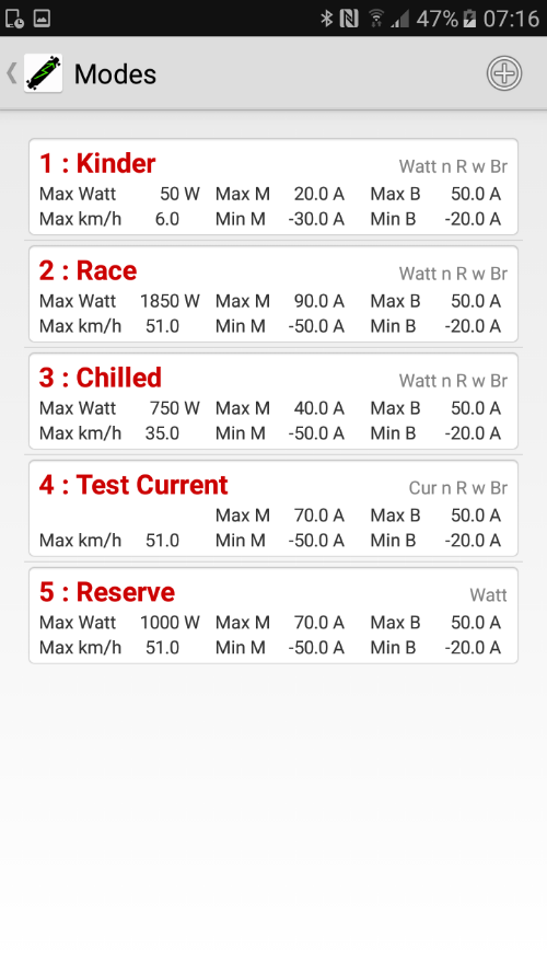

For me this App is like “welcome to the future” All the features are absolutely amazing and fantastic.
have had an meeting with @Ackmaniac on Friday and he helps me alot with setup electronics but altough with board setup… the maniac in his name dont come from nothing badass speedfreak he is thanks for your time Dude
Love the WATT control mode, in the end if ya compare it directly with the CURRENT mode ( and now you can compare directly … only one click on the App )
you will recognize that you have the same power but on a longer trigger way… this result in more control and nicer accelerations out of corners … NICEEEE
This shit is DOPE … weiter so

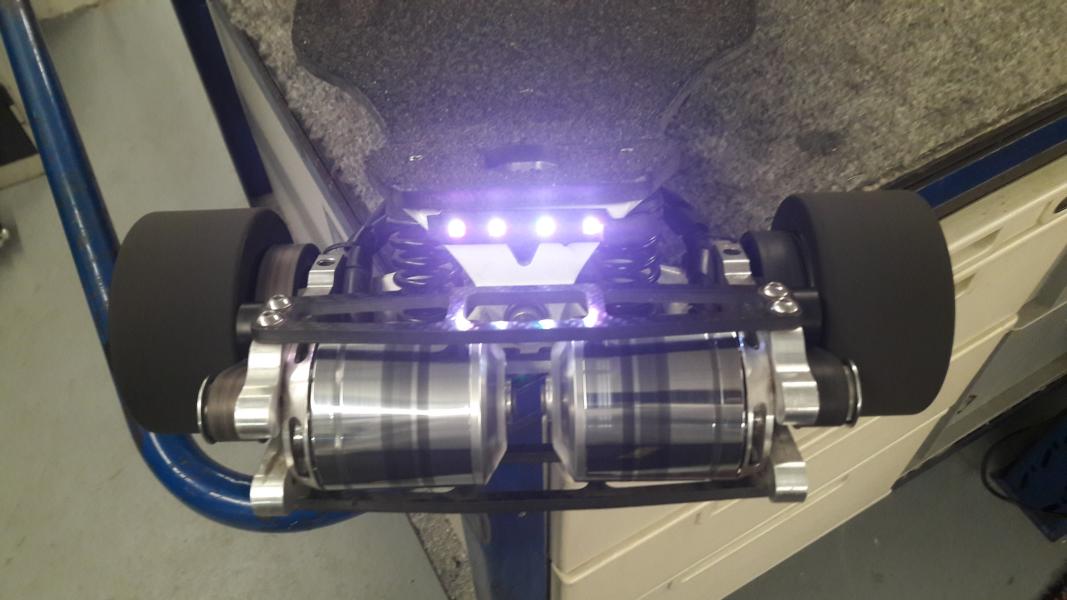

How did you hook up those lights and which controller are you using with that board? Looks epic.

Super easy Dude, its from HK some Drone lights which you mount in parallel with a Y-harness to your PPM signal… works with every ESC … signal output can be adjusted with a small poti and can be reserved for front mounting for example
