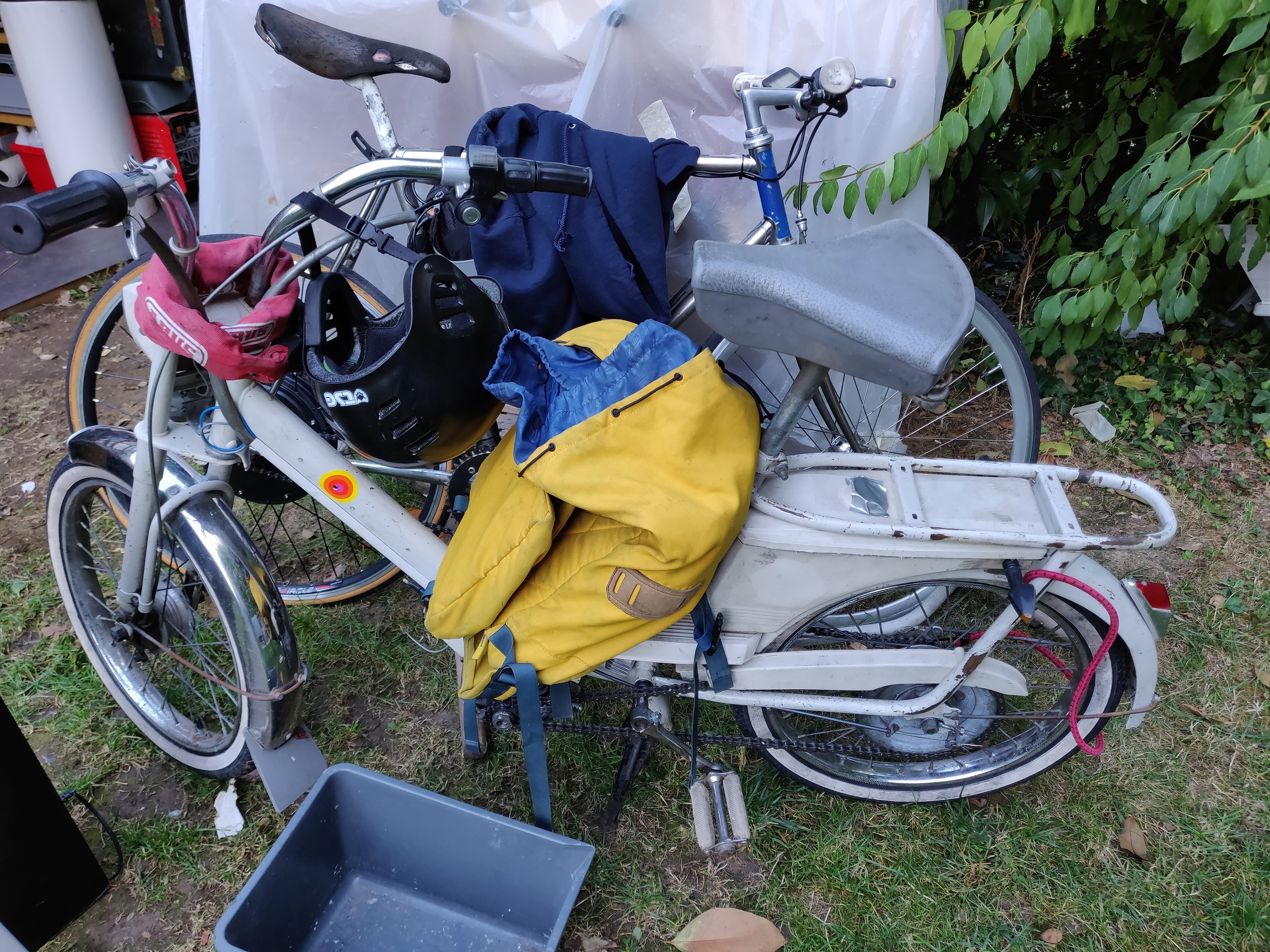

I have already this summer did a similar build while doing my Carvon V4 esk8 it way waaaaaaaay more cheap but working very well so far. The problem is that it has a lot of inefficiency in almost all it’s parts so I don’t have a great range and the build is not very well finished
A quick snap of this one :
