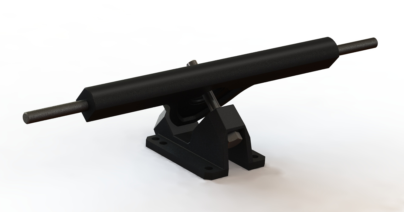

I will need to wait for the actual trucks to arrive, I don’t trust this model I downloaded, and also appears that the profile of the TB trucks are bigger than normal calibers

As I suspected the geometry of TB trucks were quite different from the model I had downloaded, there’s only two flat faces on the hanger, the board side has a really small curvature that needs to be considered if you want a perfect fit with the mount
Also the baseplate is completely different in a good way, since the pivot is farther out, you get more clearance between the motors and the bolts, but the hanger body is wider, and because of that I had to mount the motor a little bit lower
I still need to check if the axle is in the right place since the small curvature makes it a paint to measure
