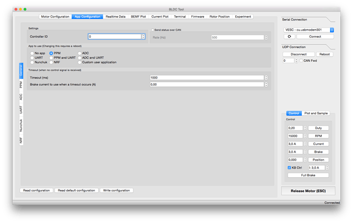

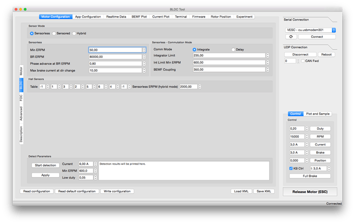

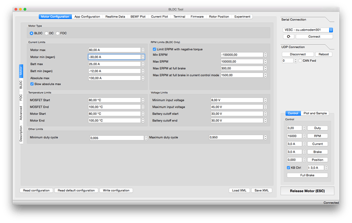

Anyone care to post screen shots of the motor config for VESC and post them? I’m getting stuttering on my bench when I hit the throttle but not during motor detection, so I’m kind of confused about what I should do. That has never happened to me before . there may already be a thread for this but my search fu kind of sucks right now, I’m home sick and feeling like crap.
I have the same issue sometimes, is mostly at the slow speed start up? If i give it lets say 30% throttle it will go right thru the shuttering stage.
I sometimes get a little stuttering when I’m on the bench too. If I simulate a kick-push by manually spinning the motor first before hitting the throttle then everything spins up smoothly. Are you able to replicate that behavior?
I’m at work now, but I can send a screenshot of my motor config later. The only thing I did besides the default motor detection was to lower my battery max (gasp!) because I’m using an Enertion Space Cell.
I changed the startup boost to what Jacob recommended in his VESC setup video, i only experience stuttering if i start from a standstill. I believe i have some screenshots on my computer and i’ll check when i’m home.
Thanks guys I really appreciate it. I have tried spinning the wheel before hitting the throttle but no dice. I’ll wait and see what’s in those screen caps. I’m sure I’ll have a great big duh moment when I see them.

You’re suffering from the calculation bug on “max current ramp step” in the advanced tab. Try setting it to 0.004 before applying “write config” and you’re safe. The calculation is 10x higher than it should be, right default value is 0.04.
Thanks! I read somewhere that you where uploading the fixed version of BLDC-tool on your website, do you have a link to it? (i’m on Mac OSX and don’t really understand the compiling thing).
I am abroad currently not able to insert the fix right now. I think Jacob Bloy is also updating it on vesc.net.au. But to be honest, it might take a few days, that task isn’t that easy as it seems. There is a bug free standalone version on github (which I am using when programming the VESCs we are selling). But in the BLDC tool itself still contains the old one in the corresponding directory on github.
To make it short: if you’re programming your VESC with ST-Link under Ubuntu you’d be able to use the new version, if going through (ported) BLDC Tool versions on OSX or Win it might take some more time for a fixed version. Until then, please stick with the above suggestion of entering the values 10x lower (= 0.00400) in that field every time before pressing “write config”.
