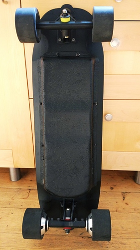

I made my “stealth” version of the board. Same board just paint the wheels… Should I call it Avenger-X now?
We’ll see how long it’s gonna last. Ciao

Haha nice, i also paint that silver things to black, but its made from aloy, i dont think the black paint would last. My only concern is about the truck actualy, i saw like 2 videos reporting broken hub trucks hmmm, they also provide extra trucks for sell tho but ya maybe thats why. Please update how the ride so far will you
Yeh I saw the video too. I hope they won’t but we’ll see it. Up to now I really enjoy it. For my commute use is really the perfect size, fast enought, nice tourque and great range. I know that they are made of aluminium and paint is not the best. In the past for my motrbike I went with powder coating and anodization. I also saw cheap kit that should work pretty well but you have to know that you will use it for multiple projects otherwise is not worth it. To paint the plate I use two coats of primer and 6 of jet black. I am sure that if you sratch hard you will leave signs but yeh I hope it won’t happen. Who designed this thing probably finished the patience once there Is your black paint lasting?

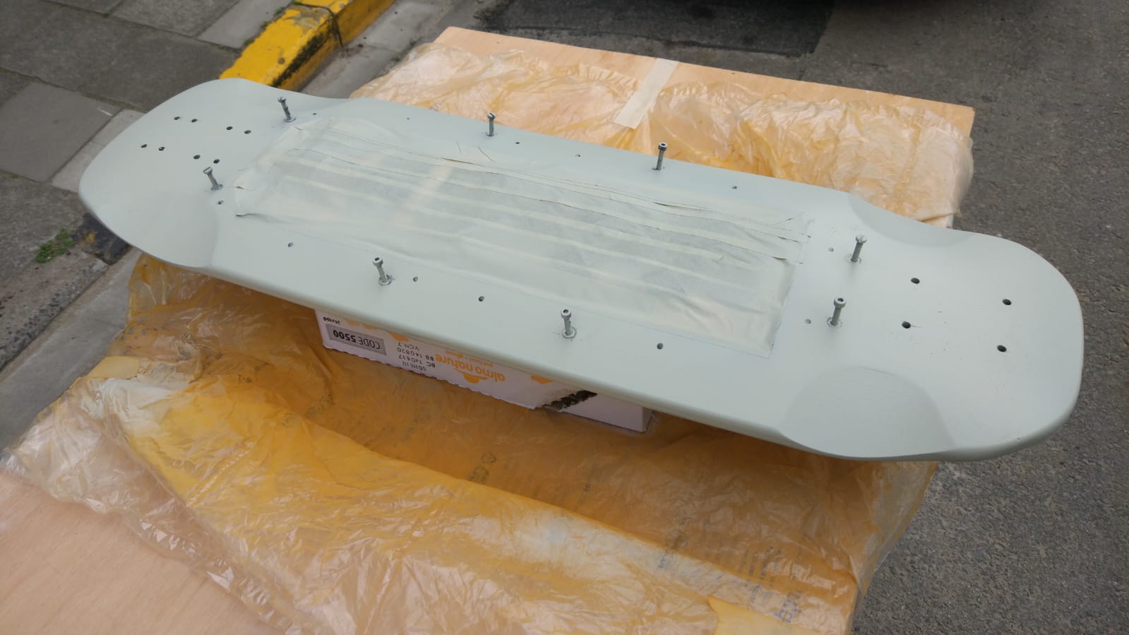

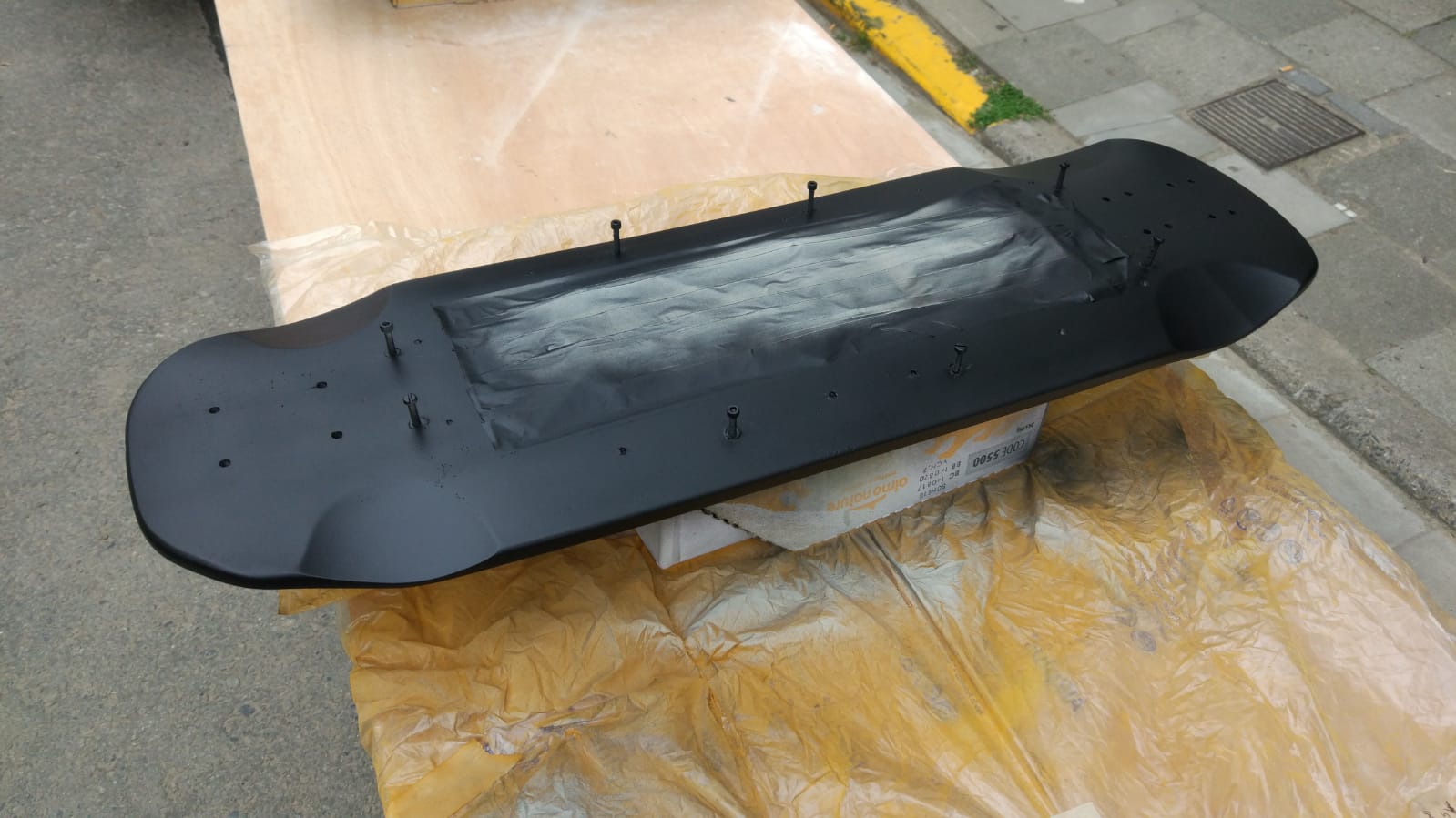

Ok! Finally I finished the fiberglass enclosure. First time. Learnt a lot, which is always nice. I didn’t get the super smooth surface because I run out of resin and I didn’t have the gel coat. I can always decide to recoat it afterwards (if I find the time and the patience). I used my old 3D printed enclosure, cut out the edges, wrapped, than resin, fiberglass, remove bubbles…check and repeat several times. Peel ply, breeder and vacuum bag (ghetto style @ninja). It came out really strong and at that time I understood how long it would take to sand it. Few hours and 2 arms gone later I cleaned up the enclosure and sanded it down as best I could until wet sanding. Made the holes for the electronics and hardware. Closed the old holes with resin to remove the bump on the top of the board. Drilled the new holes, this time went for wood threaded insert M4 x 8mm. Big thanks to @Sebike who sent them to me for free, allowing me to continue because the one I ordered were still on the way. Final steps, repaint the board, and the enclosure with first primer (filler one for the enclosure) and then Matt black. Now a sequence of pictures that tell more than the words…

Nice one! Good job!!
Very nice! Good move changing the printed enclosure to a fiberglass one!

Nice build! I love the size, quite similar to mine. I also learned alot doing the FG enclosure But felt good seeing the product. Next time(?) I hope I can get a better finish as well.
Thanks! I checked your build really nice. Moreover since you made even the board! That is on a next level. Yeh the final super smooth finish is not that difficult if you have additional epoxy or polyester resin, or even better a gel coat. It takes time but it’s feasible. How does the board run?

@rey8801 have you upgraded your battery pack or why does your enclosure seem bigger than the old printed one?
Because I used the 3d one as mold for the fiberglass enclosure. So I gained room. Which is good because the previous one was a bit smaller. Mainly due to the BMS being too big. Otherwise a 10s3p with 2 vescs fit perfectly in the original one.
