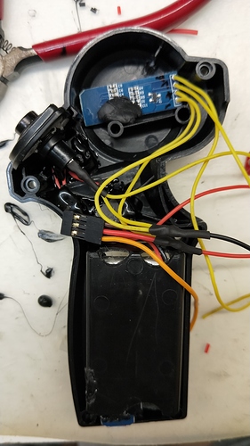

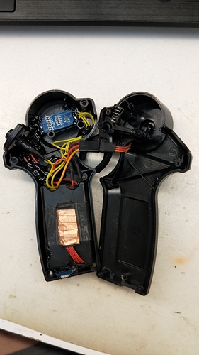

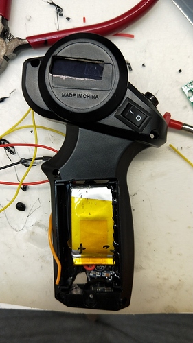

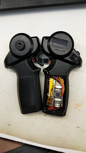

So I hacked a mini 2.4ghz remote I had lying around and replaced the internals with the same parts as the remote here (less the hall sensor, I used the remote potentiometer instead, I am also trying a smaller pololu step up instead of the one listed, just hope it can provide enough current).
Here’s my progress thus far… Everything fits after some creative dremelling. I am left with the nrf module but that shouldn’t be a problem as well.
Arduino sits on the battery (not shown here)
Will update more when it’s done and I have field tested it.

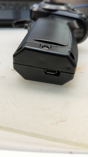

I managed to finish up the mini remote hack, here are some images of the completed product.
NRF module fits behind the battery compartment
Arduino sits on top of the battery
USB charging port

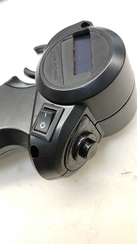

Used instamorph to close up the holes then drilled a new one to fit a single button which replaces the trigger button in the solidgeeks remote. Technically you can add more buttons here too.
Took me a while to get the throttle range calibrated and synced up with vesc but it works nonetheless. Telemetry is coming in as expected and range is more than enough for esk8.

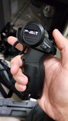

Field tested, works as expected, 8km ride with no dropouts.
One tip, don’t get distracted by reading the telemetry data and losing your focus on the road ahead…
