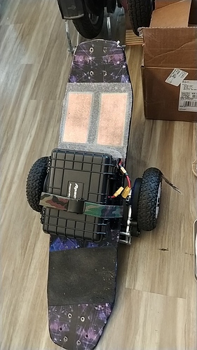

Since people are asking about geared setups, this is my current setup, it is using all mountainboard parts, and differential drive for steering (imu + channel truck = joystick). It is fast and torquey, and works surprisingly well.

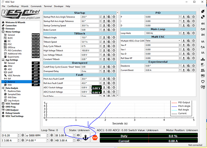

I hope I am not over stressing the 3V line, I am seeing problems where the balance app is throwing a lot of faults. It will start up and is somewhat ride able but will cut out after it runs a bit.
3V3 regulator can supply 800mA (on the 4.12HW anyway). With ithat 100K resistor in series with the switch there is no chance you will overstress the MCU or the 3V3 regulator. You only need enough resistance to ensure not more than 25mA is being sunk by the MCU. The pull-down shouldnât hurt. However, I am not sure what the threhshold voltage is for the Balance app to set the switch state to âclosedâ so it might be more consistent if you replace the 100K with a 10K so you will at least get >1.0V at the ADC pin.
What kind of faults?
I cannot tell what kind of faults they are. When I connect the VESC to a computer and ask for what faults I am seeing, it says there are no faults since startup.
When I say faults, I mean the âStateâ flickers between fault and running. However at the same time the âswitchesâ will say true or whatever so the reason it goes to the fault state is not because the switch has intermittent connection.

Hi i am having a very similar problem Iâve wired my mpu9250 to my vesc 4.12 and i cannot get any sign that the mpu is actually connected. I have it wired the same way. I was wondering if it was something i had to activate in the vesc tool but i am completely lost any help would be amazing thanks

Does anyone know what my problem might be? I have mt superfoc vesc and I tried to test out the MPU with it. I am using a 6050 MPU and I set the IMU setting to the MPU9X50. I have changed the app settings to use the balance app. I have not received any data from the MPU, can anyone help? This is my senior project for school and I have due dates so help soon would be great.
