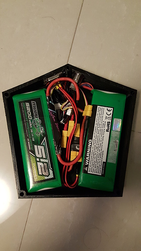

I attached the port from the inside. You can see the pictures of what the case looks like from the inside and I also linked my case design on thingiverse so you can take a look there also.
And yes the port connects to all the balance leads and the charging leads.
You need to connect the charge leads in parallel to the battery to not have to disconnect anything ever.

@Chris_KP Yes the VGA Port is great! there’s no Spark when connecting it and I’m only pushing 2amps through it. Idk how it will handle higher amp chargers but on 5000mAh battery a 2Amp charger is fine for me.
