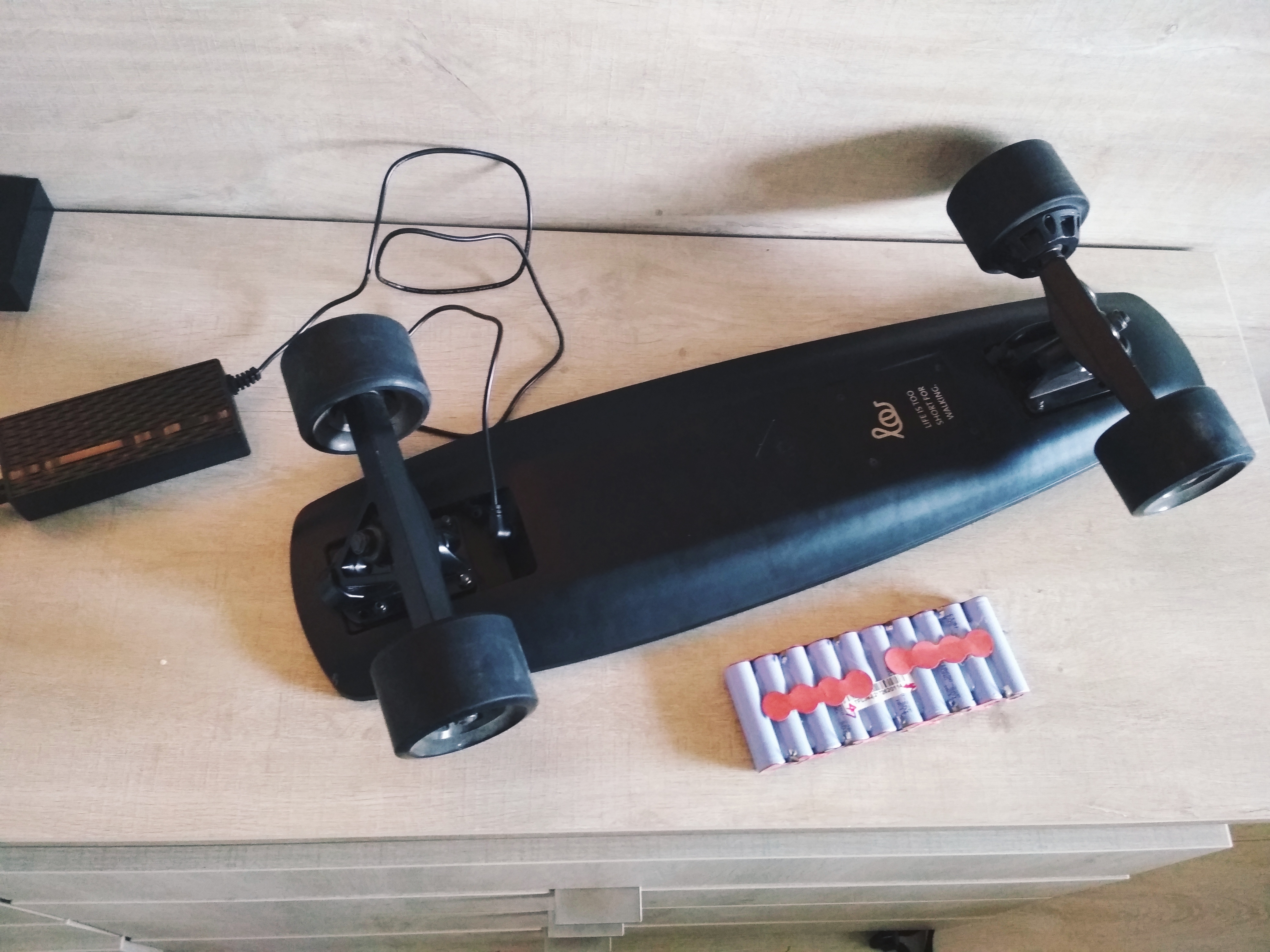

I have recently upgraded the batteries for someone to sony vct6 cells. The board runs great right now. Itâs only a 10S1P but you do 10km riding with almost always full throttle (before with the shitty Samsung cells I could only get around 5km and hills were almost impossible).
The board doesnât beep anymore when going uphill because these cells can handle like 30A with no problem.
The battery looks just like before so taking it on a plane is no problem while the Wh amount is actually a bit to much but you wonât notice from the outside
