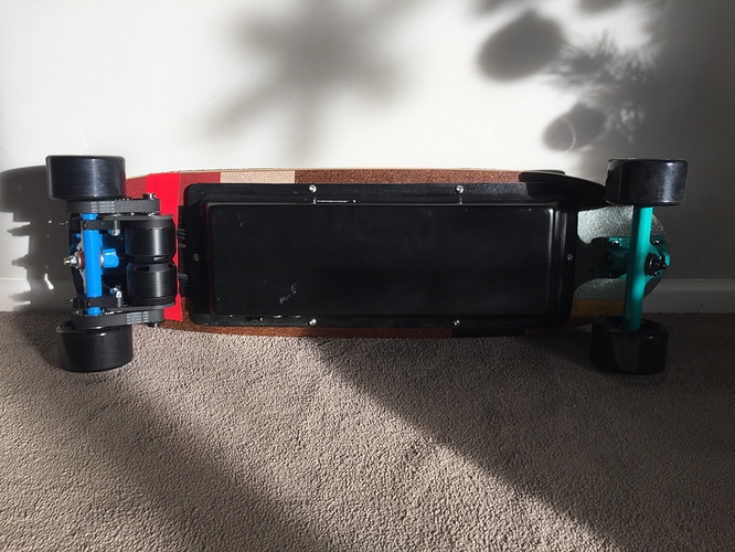

So just built up my next board after my Landyachtz 9two5 was unceremoniously bought from me by a friend. I got the Truncated tesseract from ebay and had the rest of the parts laying about from stockpiling stuff without a plan…

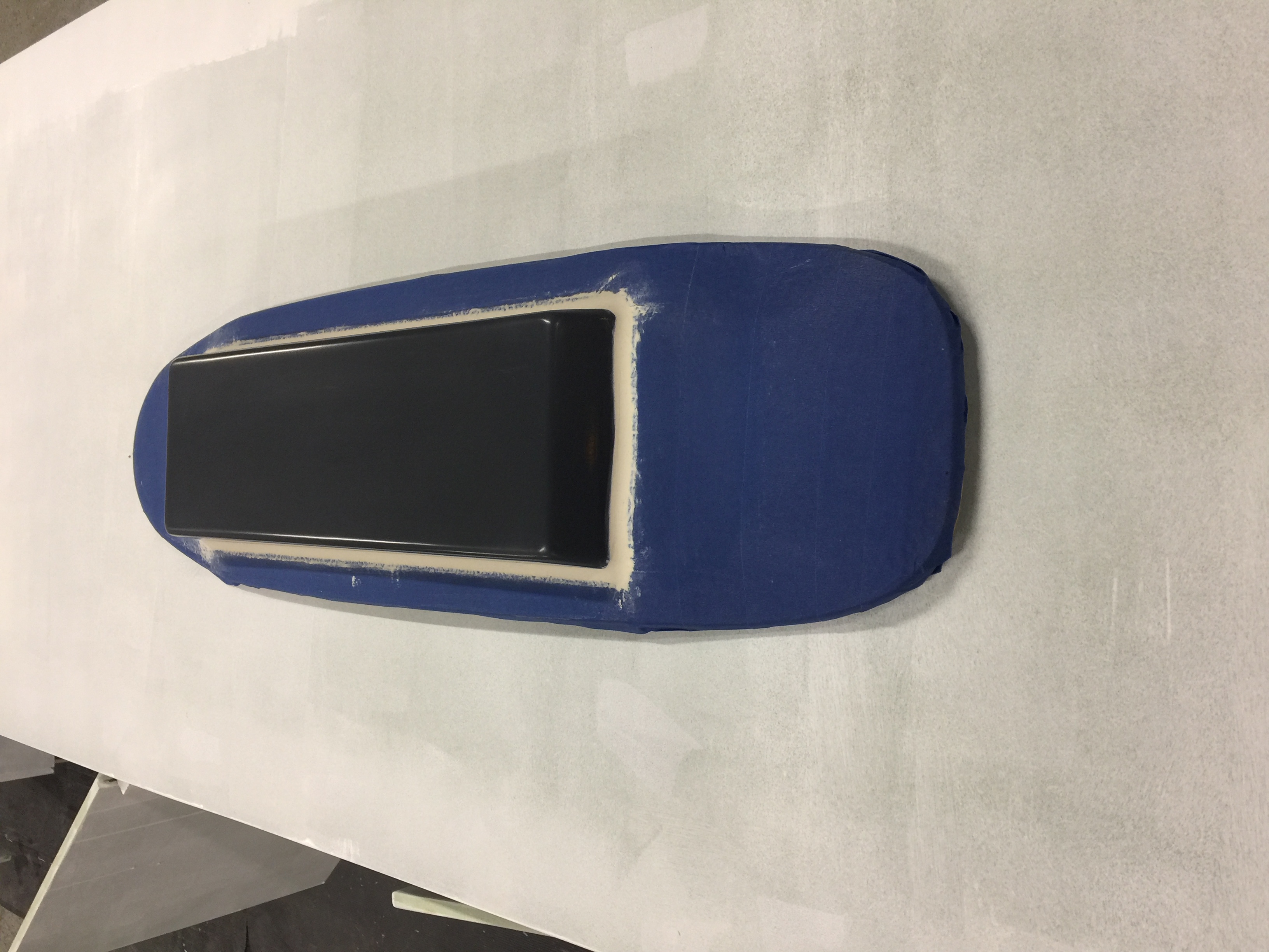

First stop was to check space. All seemed ok. Took it out for a cruise with to see what all the fuss was about with the wheels. They are really nice. Comparable to the abec 11s on my last build. So I made a plug for the enclosure and fitted it to the deck that would be good for this configuration but also with a bit of space for a triangular Li-on pack. I covered the deck with tape so some of the relief of the deck would show through on the flange but the mould would still release. The mould came off well and I layered up an enclosure. The enclosure came out pretty well and after trimming I tried it for shape on the deck. The contour was pretty good. Then I filled the enclosure with goodies. After setting ups the vescs I used the wooden inserts and button heads to fix the enclosure to the deck with the foam rubber seal. Took it out for a spin and it was very lively and quick. The 90mm wheels couples with the 15 32 ratio (APS drivers). The super soft loose bushings took me surprise on a speed run and it chucked me off… Helme, gloves and leather jacket bore the brunt but feel a little sore this morning. (I aint getting any younger) All in all its a little belter, very portable with plenty of grunt. Not had the chance to get it out again as true to form the weather has been complete arse all day. Here are some finished pictures…Dude that looks great! So the tessaract doesn’t have a kicktail?

Really nice build, congratulations. Looks neat and tidy, love the cable management as well. Not a big fan of LIPOs but I bet they do the job just fine.
