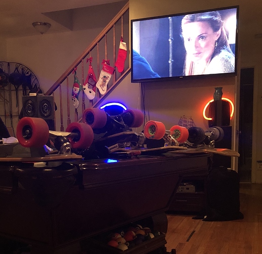

I just kicked it around with the Revenge trucks… First impressions are not good. I’ve cranked down on them way tighter then I expected and they are still too loose. They are not like my Exkate trucks.
The Rojas Axle flexes and doesn’t look ideal for a motor bracket with its small diameter. The Dr tongues look the same as Revenge and I expect same characteristics. Not sure there are other torsion options on the market. I have exkate trucks but why bother riding trucks that I can’t get bushings for.
When the weather permits I’m going to experiment with standard rear trucks and the revenge trucks on front… However I think I’m also going to order a set of double kingpin trucks. I haven’t given them much thought because they look bulky and kinda silly but they may be exactly what I’m looking for…

I’ve got the revenge trucks on just the front of the boosted and the meepo. For me its an improvement. Way more maneuverable but its not great and bad for beginners so I’m taking it off the boosted so my friends can ride it safely.
