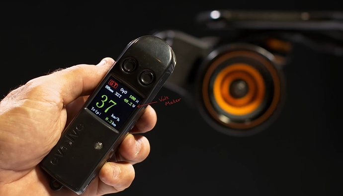

I was actually considering what you said when I realized there was a volt meter on the remote. After you said it, It pretty much confirms my thought so I think putting the voltage underneath the percentage might be very helpful.
The picture above comes from the early GT teaser and I drew an arrow to point out the fact that it shows voltage beneath the percentage. I wonder why this didn’t make it to the final version as it probably would’ve helped people a lot more than the battery percentage and significantly reduce the amount of complaints.I agree I would love to have that view on my remote. Iv’e been meaning to monitor it when the battery gets low(yaknow, for science :p) but just have never really had much of a reason to do so.
