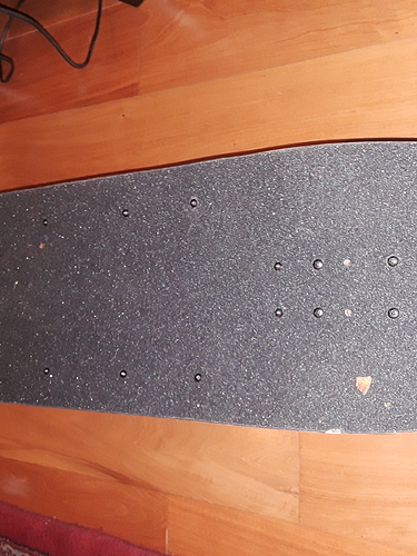

Well I’ve reshaped the nose, and finished drilling all the holes. The deck is drying now after a couple coats of polyurethane. When its dry I’ll grip it, install the sex bolts, and mount my phychotiller enclosure, and a tail guard. More photos will follow.
Custom deck?
It’s the same deck phychotiller uses for his custom builds. I read lot of post and he linked to it. Don’t remember off hand the shop. I’ve shortened deck by 2in, and reshaped nose a bit. I removed enough wood here and there that it needed to be resealed. I also wanted to get some polyurethane in all the drill holes.

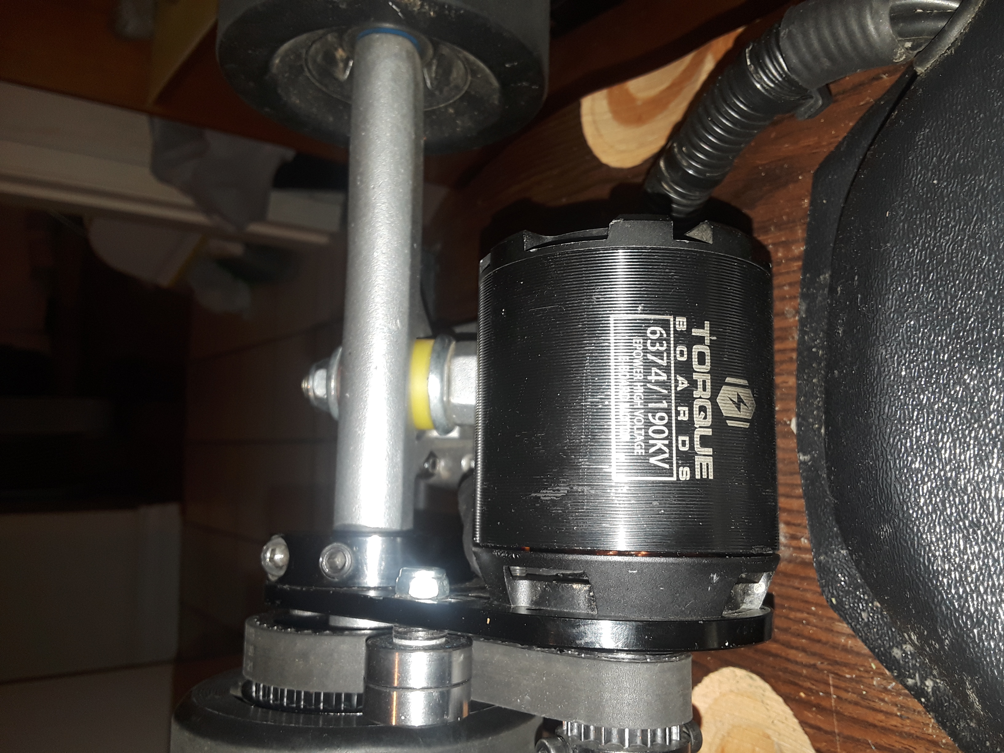

Will likely modify the motor mount first for duel idle pulleys. If the parts arrive before the battery pack. Going two idke pulleys so I can use a easy to get belts. I’m hope I can run the belt super loose with this set up.

Builds all done. Need to do a bit more fiddling but done. I used a heat gun and a handful of clamps to get the enclosure to fit the deep concave of the new deck. Just a little heat and it now hugs the curves of the deck. I’ve installed two low profile idlers on the tb motor mount. Will switch over to a 15mm belt once the wheel pulley arrives. Not getting any belt slippage except under ludicrously hard braking.
