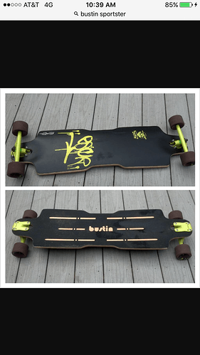

the mold took a while and that’s ok but its a big time consumer cutting the foam to the right shape. I’ve tried many different ways with an eye for accuracy and speed. I’m using a simple pattern using pattern paper now and simply a razor blade and it works but takes a lot of time. I’m excited to make a cookie cutter for the job some day and then…and then…I think I could poop them out quick and I’d like to try to sell them to YOU with a single long hubmotor! I’ve copied the bustin sportster shape and it is a drop thru with a forked end so a bit more challenging maybe. If any of u have any advice or questions… I’ll hopefully put up a pic tomorrow
