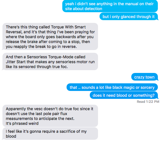

was just texting jake about the ARC units we have… he sent me this. I thought it was interesting. I’m the blue bubbles.
