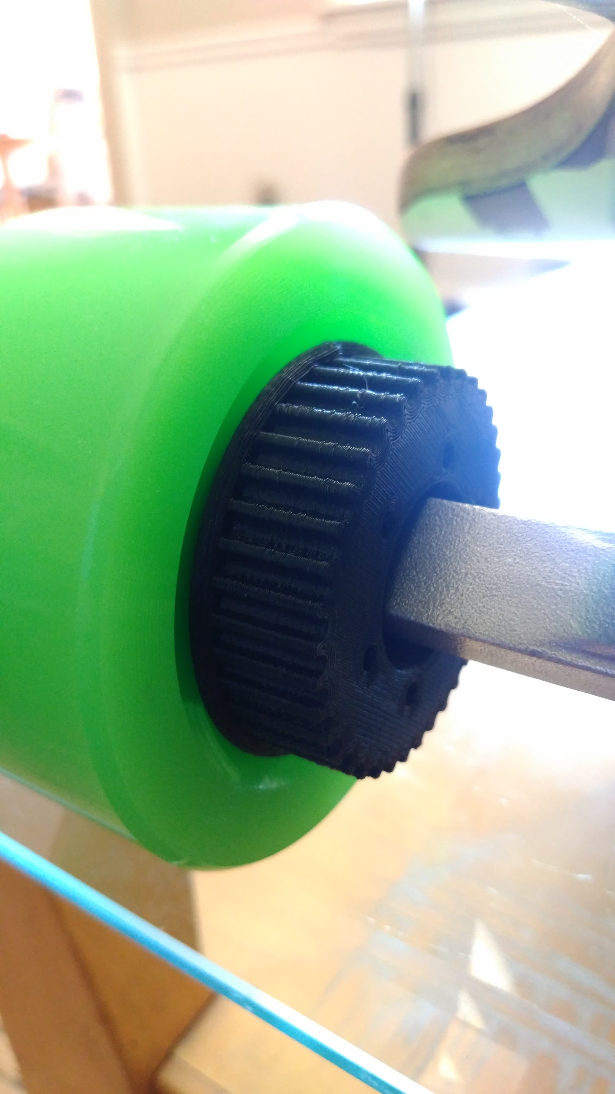

I started to think about clearance issues with the dropdown deck. So I ordered some 97mm Flywheel clones. This helped me out with 2 things. It gave me more ground clearance and gave me a wheel I can print a pulley for to test different gearing before buying a pulley set I don’t need.
