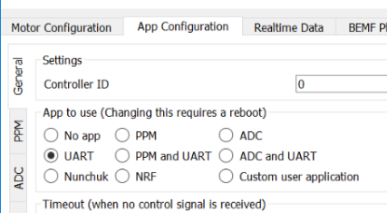

Can you be more specific on “don’t work work in this mode”? Screenshots of your app configuration tab in BLDC tool would be helpful

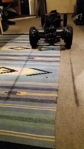

My description was confusing… I accelerated forwards a little bit, then full brake (small room) and then i put unintended full throttle in reverse ( in my head it was still the brake). As a reaction of this happening i gave full throttle forwards. This is the forward burnout on the picture. DON’T TRY THIS AT HOME. I am scared for now but i’ll try to tweak the reverse speed as you mentioned when i go watt mode again. Thanks!
Oh okay that makes more sense. Make sure you check box that says enable maximum erpm for direction switch. Idk why it’s not checked as default but I think that may have contributed to the confusion
I redid everything and started taking print screens of all the windows found the problem here
I changed from UART to PPM and now it recognizes the controller input
