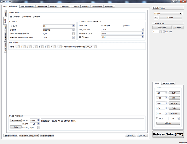

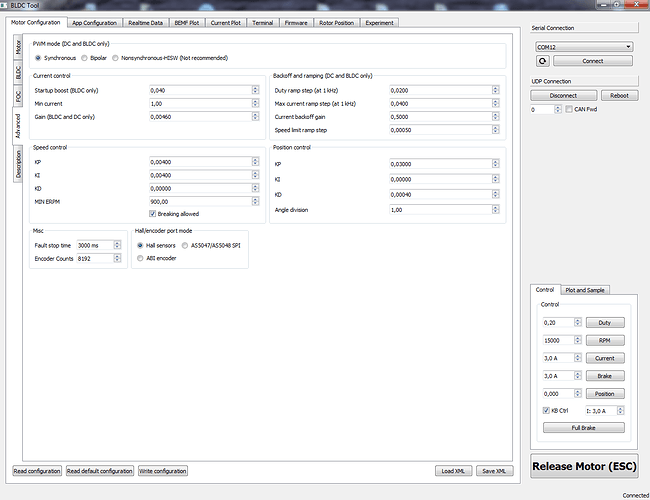

Here are my motor settings. Both VESCs have the same values:
I changed to 24000 and now I’ll test it.
With your settings you won’t feel such a big difference because the motor and battery max is very close to each other. And the moment you would feel a slight difference the ERPM limits kick in already. But you still could customize the throttle-curve.

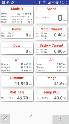

I also programmed a android app with that i can save multiple modes and simply switch while i am riding. But it only works with my modded firmware. Because i don’t want the board to keep the settings. Means when i switch the board on and off again it is back to default. It only sets it as default when i want it. That has some advantages when the cops stop me. And the Vedder firmware can’t do that.
Also it only works with Wifi via a ESP8266. Because i need this module to be smart to keep the max and min values by itself. Otherwise the smartphone needs to be connected all the time. This way i check the stats at the end of my run. But that app is something for another topic. But if somebody has a Wemos Mini D1 (ESP8266) then pm me and i can send the code and the app.
App looks like this, but i don’t want to publish it yet because when i change the firmware i might have to adopt also this app. So i will do that when it is the time.

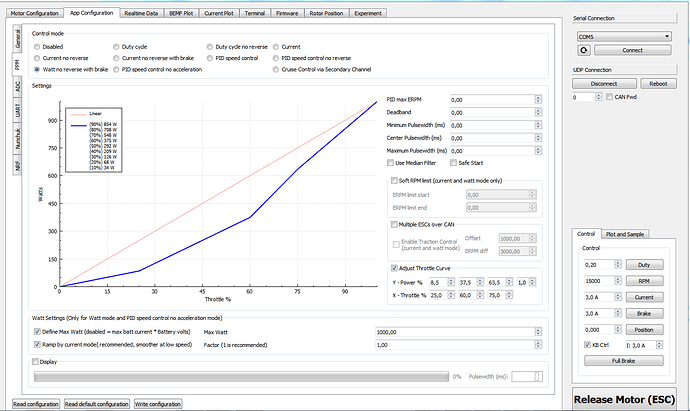

I added the new feature to soften the throttle curve edges. this way the throttle curve feels very natural. But i still left the possibility to keep the hard edges. the smoothness of the curve is now adjustable via the red marked number box in the second picture. Just try it out. Also the calculations in 10% steps are now visible in the diagram. By adjusting how curve the edges should be it is still possible to adjust very extreme curves. So with the box you can adjust how curve it should be to fit your needs.
Hard edges
Soft edges
This is version 2.51.

You should give it a try. It is really nice to reduce the power at the low throttle range till 50 %. Makes carving at mid to higher really nice and smooth. If you only go full speed all the time then you don’t need it. My board for example does 50 km/h max and carving at 30 till 35 is the best for me. And at those speeds the reduced power output from the throttle is really nice.
