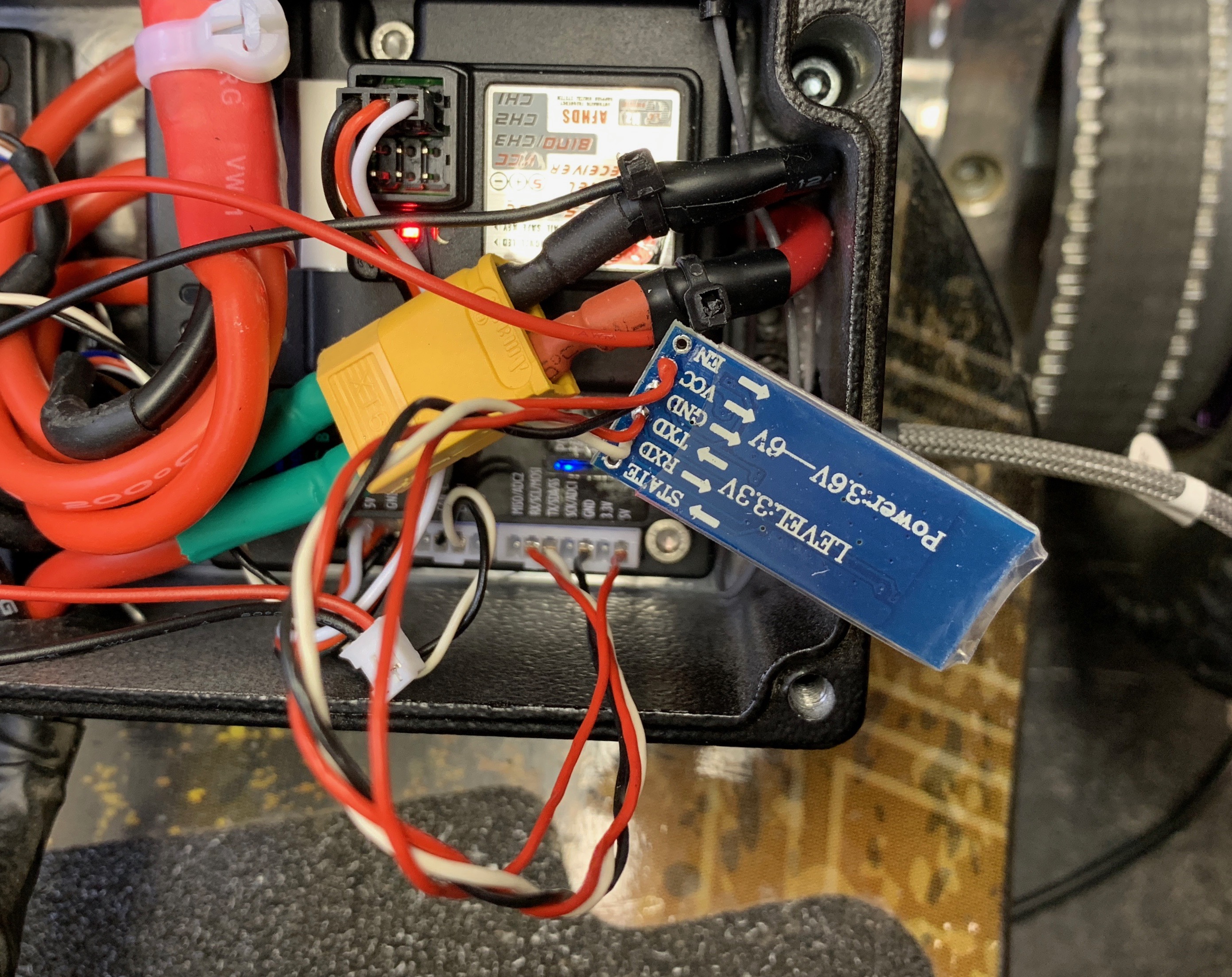

…unfortunatly i do not receive any values from the FocBox… The wiring is ok, the App gets BT-Connction but no values are displayed. Do i need a spcial FW on the Focbox or should it work with the FW displayed on the pic below…? It´s the “normal” FW uploaded with the VESC-Tool0.95…
Did you set the focbox to do uart? Do the baudrates match?
…yes
Well does your module really use 9600bps or something else? I had mine set at 115200 for example (After fiddling with the firmware on it via AT+ commands). I also think that Vedder did some modifications to the original firmware so you obviously should check @Ackmaniac’s version to be safe. (Maybe you are already using it - I am not sure from the pic you posted). I think @Pimousse made Vedder aware that his modifications break compatibility.
The module should work - a friend uses the same with 9600bps. I am using the FW from the VESC-Tool 0.95 at the moment. Not the Ackmaniac-Version. Maybe i should try to change the FW.
Yeah change it to ack’s version and report back. If you use stock firmware on the module you should be safe with 9600bps - just wanted to rule out the possibility.
Edit: found @Pimousse post: https://www.electric-skateboard.builders/t/escape-cant-get-it-talking-to-arduino-via-uart/68630/4?u=maxid This might apply to the ble module as well.
Ok, thanks for the Information I will test the alternative FW. But if i change the FW i will loose all parameters, right?
