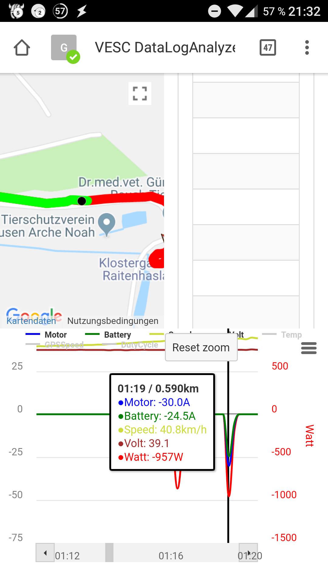

Hi, i am having a Problem while breaking downhill and i think it is related to riding faster than my setup is capable.
I did my Motor setup right and have been riding the board >200km. Running in FOC on a single focbox 10s4p 30Q’s // 200kv APS motor //normaly the board tops on ~40km/h fully charged // battery min -15A // bestech BMS charge/discharge 20/80A
I was riding 41km/h downhill and wanted to brake slightly but they were super strong and cut out immediately. I tried it 3 times more and it was the same behavior. After the incident i checked the logs and the battery min was -24,5A
So my question is how is it possible for the vesc to break on -24,5A while the setting was on -15A

Well hard to tell a i see that the first time. Maybe you were going faster than your topspeed you could reach with 95% duty cycle. Could be that the board board acts strange in this situation. But please also check in the app settings that you didn’t accidently st the number of motors to 2.
If you could provoke that situation again and make a video with the app(would be enough when you leave the phone in your pocket). Maybe you can also share your log file to investigate a bit better.

@Ackmaniac i was certainly faster than 95% duty and number of Motors is set to 1 and here is the Logfile. I can try to ride the hill again but only in 2 weeks when i’m home again

Just had a look at the logs and it happened when you had more than 95% duty cycle. In that moment the vesc tried to apply 95% which resulted in a voltage difference that leaded to the higher brake current. My advice, change your gearing so that it doesn’t happen again.
