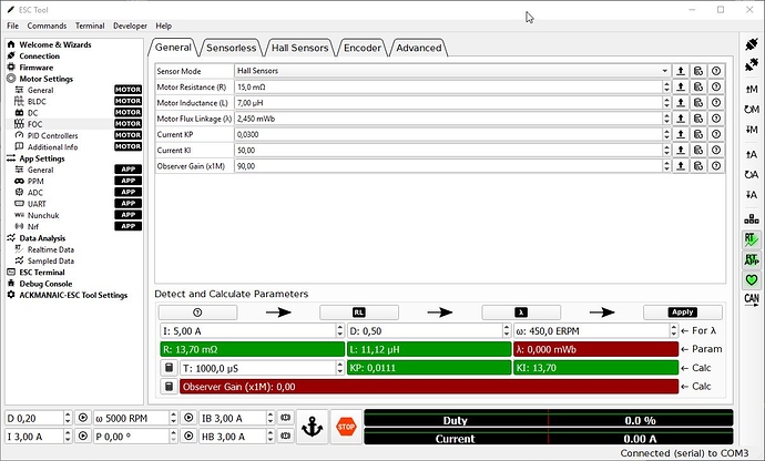

hey guys, i was working on ym board i tried to do the detection.
Motor 1, everything runs fine… Motor 2 [RL] test ok, Lambda test: no movement… Hall Sensor detection is fine. i changed the order of the motorcables to the vesc… with no result. Motor 2 runs, but i have the feeling not optimal…
Do you have an idea what i could be.
