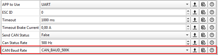

Anything change with canbus? Can’t seem to get both motors spinning now with the newest firmware.
Yes the CAN Baudrate needs to be setup now and should be the same on all ESC. I recommend 500K. And take care that “Send CAN status” is only activated at the Slave and disabled at the master. And as there are new messages for the CAN Bus all VESC should have the same firmware. So don’t try it with only one updated. just flash both and then do the setup.
