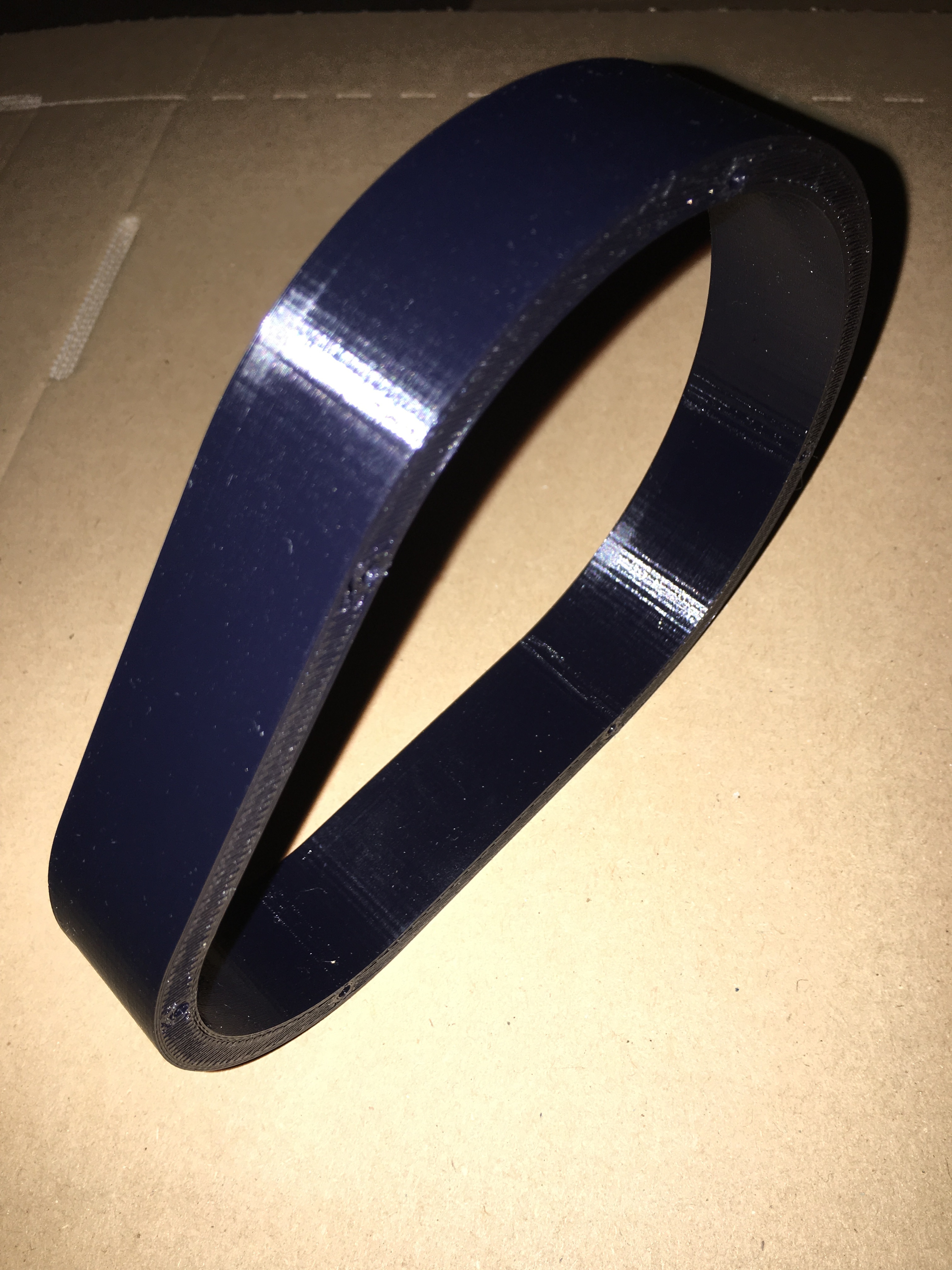

I forgot the opening for the Motor cables
You’re such a tease, you know that? Makes me want a set now!
